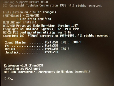

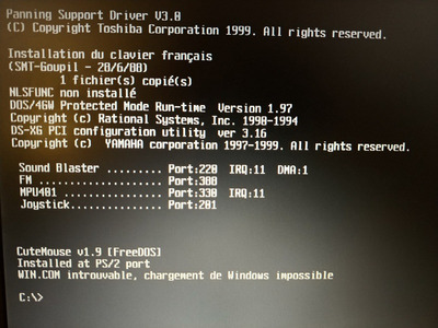

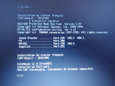

Hi !
Sorry it don't work 🙁
If i use setupds from standard installation and here is what it tells me under DOS :
832.93 KiB
2172 views
No sound, no music, nothing work.
If i launch setupds, i have this :
250.73 KiB
2172 views
Now, if i use setupds from ICH2, i have this :
226.51 KiB
2172 views
And i can see all those options and everything works :
228.42 KiB
2172 views
I can launch after that Descent and have music and sound ! Even with IRq5 or whatever (??).
But Doom don't give me sound. FM Music is okay.
I tried the swapirq trick /i11 /i5, but it doesn't help for Doom either.
Any idea ?

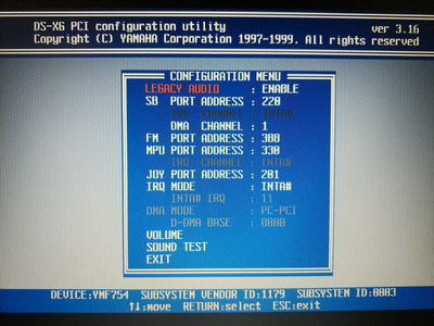

Reply 11 of 32, by Stainlesscat
firstly your sound card should not be set on the irq mode "INTA#" in setupds.
it should be set to irq mode "S-IRQ" if you are using pc-pci dma mode with your yamaha sound card, or else ymfirq won't work if the sound card is configured wrong.
after changing the irq mode, you'll be able to pick any irq number under"IRQ CHANNEL" in setupds. although dos games only see IRQ 5 7 or 9 and DMA 0, 1 or 3 as an option.
your card won't work with anything because it is set to pci irq 11 in the PC's bios and setupds uses that as INTA# for an irq, sorry thats how ds-xg works.
you should only use irq mode INTA# if you configured the the sound card to make use of IRQ 5, 7 or 9 in the bios (make sure nothing the bios is using one of those IRQ'S OR THE CARD WILL USE A DIFFERENT IRQ NUMBER!).

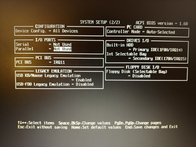

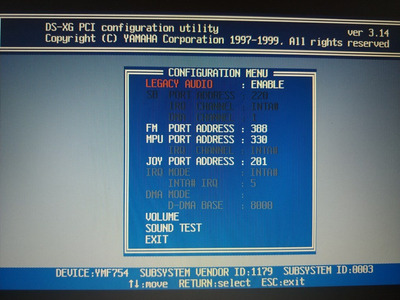

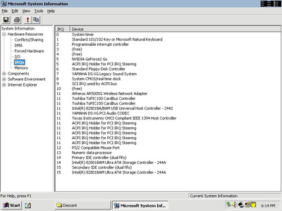

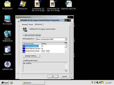

Hi everyone !

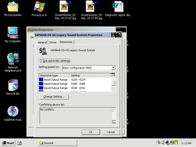

I'm still trying to make my Tecra 8200 works under DOS. Here are some pictures and results, if you can help me understand (or state there is nothing to do at this point 😉 ) :
First, in the BIOS, IRQ 11 is settled for good for the PCI devices as the Yamaha YMF754B, you can't change that :
165.2 KiB
2013 views

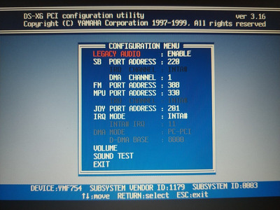

Then i'm booting using the common setupds.exe file from Yamaha, not a modified one, with the command line setupds.exe /s . It tells me that :
163.34 KiB
2013 views
When i launch setupds.exe to see what it says about irq and settings, here is the result :
229 KiB
2013 views

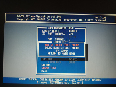

In the Sound test menu, i just have that :
194.65 KiB
2013 views

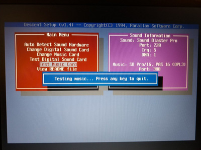

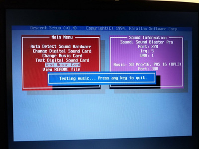

Then, exiting from setupds, when i launch the setup program from Descent, i have this : Music works, but no sound effects at all :
211.35 KiB
2013 views
Old computers and videogames freak
President of french association https://mo5.com
Get better, get old ! 😁

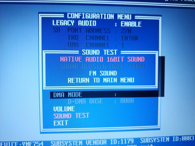

Reply 13 of 32, by Prez

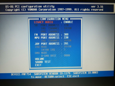

Then, i replace the setupds.exe program by the modified one for Intel ICH2 (wich the Tecra 8200 is using) and i have this now :
159.37 KiB
2013 views

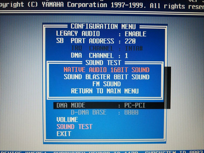

When i launch setupds.exe, i have a full more range of options now :
239.08 KiB
2013 views
And in the Sound test menu as well (everything here works) :
266.28 KiB
2013 views

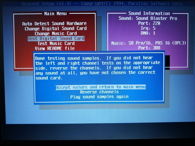

Then, launching again the setup from Descent, i can hear both Sounds effets (voice here) and the FM music as usual :
231.34 KiB
2013 views
198.34 KiB
2013 views
But when i try to launch DOOM or another game than Descent, no sound effects ever, whatever the settings (IRQ) i use !
Help please 😀

Reply 16 of 32, by Warlord
I can help tomorrow when i get time since I got this working. Also you dont need to do swap IRQ. But you do need to go into the bios and change the parallel port so it doesn't use irq 7 and disable the parallel port.
On those laptops the codec does sit on IRQ 11 but the legacy support is mapped to IRQ 7
It doesn't work for you because you because u are using IRQ 5, only IRQ 7 works.
Reply 17 of 32, by Prez
Warlord wrote on 2020-10-17, 00:51:
Ah ? ok sir, i will try. Lets stay in touch, thank you !
Best regards
Philippe Dubois
Reply 18 of 32, by Warlord
K I got Descent working fine on my Toshihiba in pure dos using SBpro for effexts, and opl3 for music. However this is an inferior way to play the game on a yamaha XG.

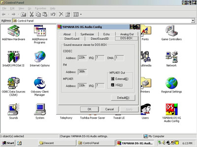

In windows I got the game working using the general midi for music of the yamaha XG which is a superior way to play this game.
GM doesn't work in pure dos on XGs only OPL3. But XG has a powerful GS wavetable that works in DOSBOX on 98.
I am going to post my driver files for you and some screen shots. DOOM also work fine.
Reply 19 of 32, by Warlord
In BIOS on 1st page you chose Parallel port std-bidirectional don't put ECP. Then 2nd page you want to put parallel port not used.
In windows it will add the parallel port regardless. So you want to manually configure and change to basic configuration 3 so it dont use IRQ. Then you want to disable it in windows.
You also want to manually configure the legacy sound system part. Change to IRQ 7 etc
