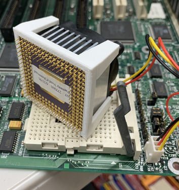

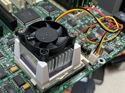

Reply 2 of 15, by douglar
First attempt didn't leave enough space to insert the chip and I had to Dremel.
Here's the second attempt to mount a 40x40x20mm head sink on a 486: https://www.thingiverse.com/thing:4659201
That's my first Thingiverse publication so I probably got something wrong.
And yes, I did affix the fan with some nasty ass salvaged screws, it's a little crooked, and it pushes out on the outside leg a bit--
This is the "Insert side". CPU goes in first

Here's the bottom:
283.25 KiB
647 views

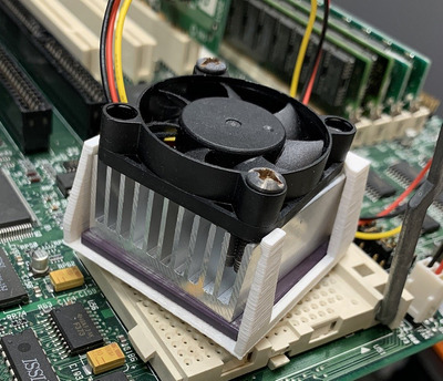

Here's the "snug side".
The heat sink slides in from the open side. That caused the thermal paste dollop to form.
Takes a moderate amount of pressure to push the heat sink in, but it snaps in place with a satisfying pop.

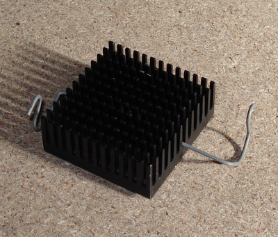

Reply 5 of 15, by Tetrium
douglar wrote on 2020-11-20, 21:37:
Tetrium wrote on 2020-11-20, 20:14:
This is interesting, particularly for those boards that do not have any of those socket tabs at all (early s3 CPU sockets).
I'm not sure if the board pictured here is the board you are trying to create this fan mounting printed assembly thingy for, but even with just the 2 tabs (1 each side) and both near the edge instead of centerlined) it's possible to mount a larger heatsink using one of those z-wire clips, like for instance this one here
https://commons.wikimedia.org/wiki/File:Pin_f … th_a_z-clip.png
I made a Z clip out of low gage springing dental wire, but it had a bad habit of slipping off the clips and I was worried that it was going to fly off and short out the mobo one day
Valid concern indeed.
I never had to make my own as I had salvaged several off of some old P1-era machines.
The clips look like the one in this pic (bottom row, second most right one)
This pic was posted by Anonymous Coward back in 2012 here on Vogons.
Another pic showing the z-clip mounted onto a (quite small) heatsink here (pic by me) :
My retro rigs (old topic)
Report spammers here!
Reply 6 of 15, by Tetrium
Is there a place that sells socket 3 Z clips ?
I just noticed your edit:
I don't actually know if it was ever sold. I got mines from larger passive heatsinks that were mostly used in P1 OEM machines.
There are chipset heatsinks that were sold which used similar clips BUT I don't know if these will fit s3/s5/s7/s370/s462 (all these sockets actually have the same dimensions).
Perhaps someone else here has an idea on how to get them, but I don't know alas 😒

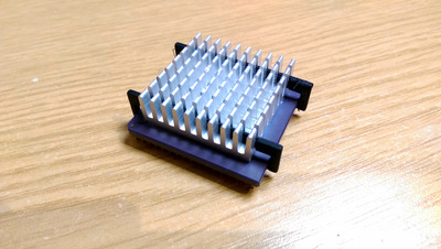

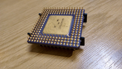

Reply 7 of 15, by adalbert
I once 3d printed some very thin clips, you just press fit them between heatsinks fins and clip the hooks to the underside of CPU. I made them 4 years ago and they didn't break. But it's worth mentioning that I am using regular white thermal paste, which is pretty sticky and its acting a bit like glue. Clips are attached only to two sides, but they are holding the heatsink in place pretty well.
Can't find the STL file, but it's a simple design. I printed it with ABS, it worked even without heatbed because it's a really small piece. Maybe PET-G would work too.
(that white clip on last photo was a prototype carved by hand)

Reply 11 of 15, by douglar
Thanks for the feedback. I was using 12 gauge wire, and I think it just didn't have enough strength. I'll use my printouts until I find some 8 gauge wire for Z-spring or until thermal fatigue breaks down the plastic filament.
Oven tests seem to show that the filament I used starts to get undesirably flexible at 150f/65c and starts to get ductile after 200f/95c
