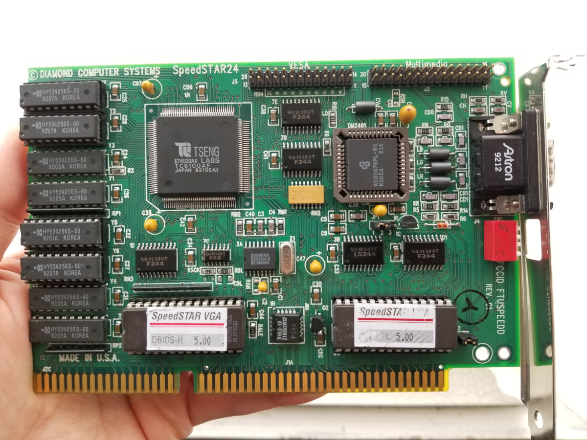

I picked up Diamond SpeedStar24 ISA video card with BIOS version 5.01, but every test I run only indicates a 256 color RAMDAC, including Tseng Labs own VESA driver and UNIVBE. The RAMDAC is a Samsung KDA0476PL-80. The datasheet seem to indicate that is truly only capable of 256 colors. I have seen in this post that this RAMDAC has show up in other Diamond SpeedStar24 cards.
ET4000AX variants
So was the RAMDAC swapped out for a 256 color one or is something else going on? I am just trying to find out why a supposed 24-bit color card is only producing 256 colors.

If I had to guess, Diamond simply made several different versions using the same board and stencil.
I've seen versions of the SpeedSTAR 24 with a Sierra SC11483 15-bit DAC too.
Fitting a 24-bit capable RAMDAC (try looking for the SS2410 or Music MU9c1880, those are the same chips that the 24-bit DAC the 'high end' versions came with) ought to give you the higher color depths you want.

Yes, there were at least three variants of SpeedSTAR24, see the pictures in this thread:
Diamond Speedstar24 Bios versions
In 2003, I voted in favour of joining the European Union. However, due to later developments - especially the restrictions on cash usage - I have withdrawn my support. DOWN WITH THE EU!
Reply 4 of 24, by jasa1063
Grzyb wrote on 2020-11-07, 21:25:
Thank you for pointing out that thread. It appears that different RAMDACs may require specific BIOS from Diamond to work properly. I could put another RAMDAC in only find out I am no better off. I am just going to run the card with 256 colors. It is currently in a Tandy 1000 TL/2 anyway. I have a Micro-Labs ET4000AX board with an AT&T 24-bit RAMDAC I can you use for other builds. Glad I asked about this card.

Reply 14 of 24, by pshipkov
Interesting topic.
I happen to have 2 of these cards. One with 24-bit DAC and a second with 8-bit one.
24bit
8bit
They are identical, except a "made in USA" print.
The second card produces subtle and hard to describe with just words incorrect background color fill during palette transitions in some games. Where it should be black it is sometimes dark blue.
Not sure if this is because of the .01 difference in the BIOS between the two cards, or maybe it is the DAC. The problem is so minor that i never bothered to investigate.
Other than that i didn't actually notice much difference in picture quality, but i use them mostly on 286 and 386 class computers where 8bit graphics are the norm and there is a chance i missed something obvious.

Captured 2 short videos from Wolf3D running on a 286 PC:
This one shows the video card with 24 bit DAC and BIOS version 5.01:
https://www.petershipkov.com/temp/retro_pc_im … x_24bit_dac.mp4
And another one showing the card with 8 bit DAC and BIOS version 5.00:
https://www.petershipkov.com/temp/retro_pc_im … ax_8bit_dac.mp4
Notice the blue color fill flashes.
I cannot remember which other 2 or 3 games i have seen this artefact in.
Was it Indiana Jones and the faith of Atlantis ?
I never looked at what may be causing this minor issue, so take the info for what it is.
retro bits and bytes | DOS media library

Reply 19 of 24, by pshipkov
Then it looks like a BIOS version specific issue, assuming you are running 5.01
I can swap DACs and BIOSes around, but i doubt it is DAC specific.
