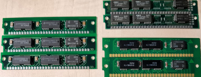

Hello,
I have theese 30pin SIMM modules ( each od them is 512kB - I hope ).
I tried to use them in 386 or 486 motherboards, but BIOS cannot read them. It is strange, because there is no problem with all my 1MB modules.
Any idea how or where to test them ?
Thanks,
David

Reply 1 of 13, by debs3759
Are they double sided? That poses a problem for some motherboards.
Reply 2 of 13, by Dave Bursik
No, they are not double sided.
My 1MB modules are 1 sided too - there is no problem.
David

Reply 4 of 13, by Dave Bursik
I tested them on:
M321
M396 VR1.1
Unichip UNI-386WB 387C REV1.0
Also I have HED-988 board, but unfortunately there is possible to use only SIPP modules 🙁
Reply 5 of 13, by Grzyb
They are 256 KB + parity.
Are you sure the bank is filled up?
Memory bank = 2 x SIMM30 for 386SX, 4 x SIMM30 for 386DX/486.

Reply 7 of 13, by Dave Bursik
Grzyb wrote on 2020-11-19, 17:12:
Each module has two 256kB chip and third one for a parity. So I assume the capacity of each module is 512kB.

Reply 8 of 13, by maxtherabbit
Dave Bursik wrote on 2020-11-20, 16:21:
David
Each "256kb" chip is 256k x 4 bits. It takes two of them to make 256 kiloBYTES

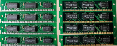

Reply 9 of 13, by Dave Bursik
maxtherabbit wrote on 2020-11-20, 16:23:
David
Are all of them 256k x 4bit? I think just two modules are 256k x 4bit..
Reply 10 of 13, by maxtherabbit
Yes. Punch in the IC part numbers into google and see for yourself
Reply 11 of 13, by zyga64
Third IC (for parity) is 1-bit wide, which results with 9-bit SIMM.

Reply 13 of 13, by Dave Bursik
Hello,
thanks. I checked DRAM configuration for the M321 motherboard.
DRAM CONFIGURATION
Size Bank 0 Bank 1
1MB (4) 256K x 9 NONE
2MB (4) 256K x 9 (4) 256K x 9
4MB (4) 1M x 9 NONE
5MB (4) 256K x 9 (4) 1 M x 9
8MB (4) 1M x 9 (4) 1M x 9
16MB (4) 4M x 9 NONE
20MB (4) 4M x 9 (4) 1M x 9
32MB (4) 4M x 9 (4) 4M x 9
So I think my modules should work with motherboard ... ???
Each module is 256k x 4-bit +256k x 4-bit + 1-bit wide parity chip
David
