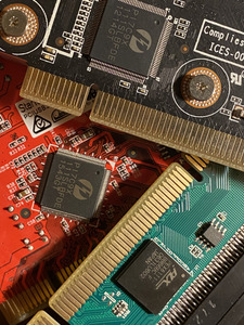

I have a multi booting k6 3+ system that has a pci usb 3.0 card in it. The drivers say it's a "Renesas usb 3.0" but sold as "Startech 4 Port PCI USB 3.0 Card" it works fine in windows 7 but I was wondering if I could get it working on ME as well?
has anyone gotten something like this to work in 98/me if even only at usb2.0 speeds

Reply 7 of 20, by Sphere478
weedeewee wrote on 2021-02-13, 19:02:
Hey Sphere478,
Could you take the card out, take a picture of the backside, and post it here.
It seems like there's a chip on the backside, probably the PCI-PCIe bridge chip and I'm wondering which brand/model/id it is.
red one
Sphere's PCB projects.
Reply 8 of 20, by weedeewee
Sphere478 wrote on 2021-02-14, 14:55:
red one
cheers, that matches exactly with the chip on a photo I found online of that same card. 😀

Reply 9 of 20, by weedeewee
Sphere478, Could you test them, to see if they're working, in a Asus P5A or similar SS7 mainboard with ALI chipset ?

Reply 11 of 20, by weedeewee
Sphere478 wrote on 2021-02-14, 17:30:
It probably would. Only board that has given me trouble was a lga 1155 msi board it seems to work well in most boards
I only have 430yx/hx socket 7 boards
I tested one pci-pcie bridge on an p5a and it didn't get detected. Haven't tested it yet on any 430?x boards yet.

Reply 12 of 20, by Doornkaat
weedeewee wrote on 2021-02-14, 17:43:
To my knowledge +3.3V isn't present on the P5A PCI slots. Could it be the bridge needs that and you have to hack your board to supply the voltage?
Reply 13 of 20, by weedeewee
Doornkaat wrote on 2021-02-15, 13:17:
Could it be that simple ? I'll test it when I get the chance. Thanks !
edit: I'm gonna say you're right without testing it. I've looked at the bridge and ... All the 5V lines are connected to each other and a few caps, though nothing visible goes to any chip that might be a regulator.
So I took out the multimeter and measured around and... aside from the 5V lines in the back being connected together, and the 5V lines on the front being connected together with some caps. They aren't connected to anything else. So yep, this board needs a 3V3 line on the pci bus to function.

Reply 16 of 20, by weedeewee
Confirmed, Asus P5A has no 3v3 on the PCI slots.
