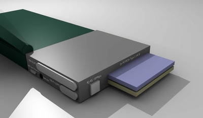

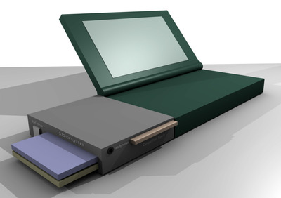

Reply 27 of 114, by radiance32
Hi again yyzkevin,
I let my imagination loose and made a quick 5 minute 3d model of "The Imaginary Penultimate Expander" for the 200LX 😉
This would be a device that slides into the PCMCIA slot on the left of the HP Palmtop, similar to those Amiga 500 hard drives that attached on the left of the A500.
The PCMCIA card that goes into the Palmtop hold the device in place (hopefully), and multiplexes the PCMCIA bus to the 2 card slots and all the other features inside,
so to the card services, it just looks like a large bunch of PCMCIA cards...
I tried to put everything a DOS Palmtop user would ever need into one expander device,
it's way too optimistic though, I don't think its possible to build something like this at the small size of the expander in the images,
it would have to be larger, and have less functionality/connectors to be buildable and affordable 😉
But it's a great "target" to try and design and build something as close as possible to it...
It could also be built to work in other machines too, besides DOS HP Palmtops...
Although it's a very quickly built and crude 3d model, the dimensions of everything are correct, i looked up all the dimensions of the 200LX, PMCIA cards, CF card, etc...,
except for the DB25 and DB9 ports, I eyeballed those from a photo, and I think they are a tiny amount too large...
87.56 KiB
1345 views
Front View
74.85 KiB
1345 views
Rear View
7.83 KiB
No downloads
Wireframe isometric top view with text labels
This penultimate device has:
* 2 PCMCIA slots, for 2 Type 1 or 2 Type cards, or one Type 3 card (which is too thick to allow for 2 Type 3 cards so it fits into the bottom slot and takes up both slots)
* a headphone 3.5" stereo jack on the front, and a 3.5" stereo line out jack on the back. These could be connected, for example, to an internal opl3 and/or some buffered digital audio chip inside, or simply a COVOX clone on an additional parallel port.
* An extra DB-9 RS-232C port as COM2, which is connected to a UART in a straight fashion, unlike the palmtop's built-in COM1 port and cable, so you don't need a null modem adapter and can connect a serial mouse directly to the COM2 port.
* A D25 parallel port as LPT1
* a female RJ-45 socket, connected to a 10Mbps PCMCIA LAN chip out of a PCMCIA network card that's supported by the 200LX.
* a CompactFlash card slot on the front capable of using standard (up to 32/64 MB), or, up to 2GB cards with the acecard3 driver.
Power is provided through a USB Type-C connector at the back of the device.
All these features would be connected as PCMCIA devices on the PCMCIA bus, of which, I'm still not sure how many PCMCIA devices are supported on a PCMCIA 2.0 bus. (I need to do some further googling/searching for this information, and I hope it's more than 2 😀 🤣
But I have read that the PCMCIA 2.0 design is based on the 16-bit ISA bus, so I have a hunch it should support more than 2 PCMCIA devices and all the functionality in this unicorn expander might be possible, but in a bigger box 😀 🤣 ...
Anyway, this is just a purely fantastical idea that I don't think will ever be created, but it's a great design goal to try to build something resembling this with less functionality, but as close to it as possible...
I don't think it will be possible to cram all the necessary hardware into the size of this expander, so a real-world, realistic one would have to be a bit larger, or, features will have to be removed...
Actually, you probably won't be using the PCMCIA slots a lot of the time as nearly everything you would ever need is already provided in the expander...
For something more realistic, buildable and affordable, maybe just a device of similar size/dimensions, but just the following functionality:
* 2x PCMCIA Type 1 and 2, or 1 PCMCIA Type 3 card
* A DB25 LPT1 port at the back
* an opl3 chip (adlib compatible) with the headphones 3.5" stereo jack on the front and the line-out jack on the back to connect to a pair of speakers...
* a USB Type-C connector at the back for power.
* All the rest like CompactFlash storage, ethernet and/or an additional serial port can be done with cards in the 2 PCMCIA slots 😀
And, if there is any room left, maybe a small one-cell lithium-ion or lithium-polymer battery, that's charged by the USB Type-C power supply/regulator IC.
This doesn't need to be a big battery, just enough to power the unit for 2-3 hours would be a great start, something like a one-cell 1200mAh lithium-ion pack.
Cheers,
Terrence
PS: https://lab.yyzkevin.com very cool, all in a browser window 😀 but it asks for a username after I launch the IBM classroom lan manager...
Check out my new HP 100/200LX Palmtop YouTube Channel! https://www.youtube.com/channel/UCCVChzZ62a-c4MdJWyRwdCQ
Reply 28 of 114, by yyzkevin
>lab username is guest
that is a nice render. I could build the circuit board for that in a day or so, mostly. an issue though is, when the onboard LPT1 is enabled I believe I would need to disable one of the slots. And, the OPL chip when enabled would use that same LPT port, otherwise we would need to disable a second slot. The OPL would be presented via lpt so OPL2LPT software and patches etc could be used.
I think, because it is so easy, that I would put the uart in it attached to an ESP8266 virtual wifi modem.
i need to hookup the doubleslot and see what it is doing, I suspect it is presenting two single-function cards as one multifunction card. I will hook it up and see how the CIS is presented to the host etc, I need to learn more about the limited (nonstandard?) pcmcia implementation on the LX
Some current PCMCIA Development I am playing with. This is the HP200LX again logged into a netware server, this time over wifi through the esp8266 pcmcia card
www.yyzkevin.com

Hey yyzkevin,
Thanks, I built and rendered the images on my SGI Octane2 Irix system from 1995,
the same one seen in this video: https://www.youtube.com/watch?v=_dI9fg8A3sM
I also borrowed it for a few weeks to LGR (eg, clint) for a review which is here:
https://www.youtube.com/watch?v=ZDxLa6P6exc&t=2s
You seem to have the experience and knowledge to produce a board for an expander like this,
but do you think you have the time necessary to help to design the board and getting it all working?
I could help in other ways, I could do the design of the expander, make 3d models for 3d printed cases and get them printed with my friend's 3d printer,
and provide funding for getting a company like PCBway to produce a set of starting boards,
source the components and I'm pretty good with soldering so I can help solder a first small batch of prototype boards...
Are you willing to try and build this with me? Do you think you have the free/available time to do it?
There is no rush, so it doesn't matter if you do it tomorrow or next month 😉
Give me a day to think this through and I'll get back to you, maybe in the meantime, if you have the time, you could have a look at your accurite doubleslot,
and try to figure out how the bus works... if it's just a simple ISA-like multiplexed bus, or if it's like you say, "I suspect it is presenting two single-function cards as one multifunction card.",
and if that allows us to build an expander like the realistic version with the additional LPT port and an OPL3 chip I mentioned in my post with the 3d renderings... (or something similar like what you are talking about)
Or, we could ditch the opl3 chip and go for an integrated network card instead... ? what would you prefer?
I'm off to bed, it's late here in New Zealand 😀
Cheers!,
Terrence
PS: Love your project.... The WIFI stuff is very interesting, maybe that could be an option for an expander? WIFI connectivity 😀 what kind of wifi protocols does it support and how fast is it approximately ???
Cheers,
Terrence

lolo799 wrote on 2021-02-15, 21:32:
Found that website, is it yours yyzkevin? https://hackaday.io/project/52693-200lx-modules
No but that is nice. The thing that is great about the HP 95/100/200LX is that we get that nice pin header on the right side for a serial port. It is easy to make custom cables, or little dongles etc.
The problem is my daily retro driver so to speak, is an IBM PC110 and it has no serial port accessible without the docking station, so that is what sent me down the path of designing an ESP8266 PCMCIA Card. Then along the way I learned about the HP palmtops and made some changes to the power supply to stay below 150mA while transmitting on Wifi, but some users mentioned how the card would have limited use in the HP given that it removes the ability to have the flash storage. Enter the Doubleslot, I got it to try and learn how I could present both my serial function and a storage function in one card, in a way supported by the HP.
And here we are.

Reply 34 of 114, by radiance32
Hi Kevin, I'm waiting at the doctor's office right now (I am having my gallbladder removed with surgery at the hospital in 2 months), but when I get home in a few hours I'll make that raw dump of the parallel pcmcia card and send you the Cic driver / enabler that's on it...
I think your proposal for the features of the expander are very good, and somewhat close to what I was thinking of and described in my thread with the 3d renderings...
I am also very excited about the wifi feature you are suggesting... 😀
If you want I would like to design the housing and get some 3d printed in aluminium or something a bit more strong and quality looking that a standard home 3d plastic printed part..
I'll make a more detailed response and get you those parallel port card files in a few hours when I'm home, but, can you tell me how to get the raw dump of it ? What's the best tool to use under msdos on a 200lx ???
Lolo -> I will also get you those BIOS versions...
