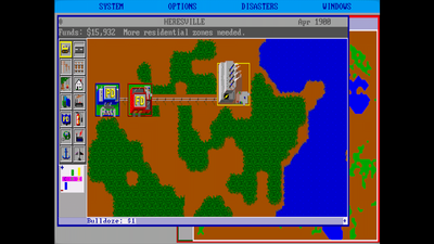

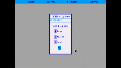

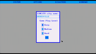

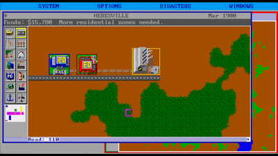

I have a question about the correct aspect ratio setting to use for the original DOS version of SimCity running in DOSBox.
I thought that using "aspect=true" provides the most authentic experience, given that it attempts to scale the screen to the 4:3 ratio of old CRT monitors. I use this for almost all my DOS games.
There are a select few games, of which SimCity is one, where this seems to fail. Based on the attached screenshots, selecting "aspect=true" appears to squash the screen vertically, making all the squares look like rectangles.
I am wondering why this is so, and is there a way to obtain a proper 4:3 ratio for this game (and others) while avoiding distortion in the image?

There are so many variations of Dos Simcity that it's hard to know for sure, but is that not the EGA high resolution mode of 640x350? If so, that's going to be a narrower picture than either 320x200/320x240 or 640x400/640x480.

Yes, it is the EGA high resolution mode. That must be it then.. the non-standard resolution does not work properly with the aspect ratio correction, which is designed for the standard 640x and 320x resolutions? I expect there is no way to get around that then, apart from playing it in the lower resolution mode. Or leaving aspect ratio correction off and playing in widescreen mode, which while less accurate is at least more pleasing to the eye.

To be more specific, there is a known issue with the aspect correction of 350-line modes when using the machine=ega setting, which includes text modes due to the 14-line font. However, I'm not aware of any compelling reason to use the EGA machine type for original SimCity.
The attached screenshots in the first comment of this thread seem to show the aspect correction working as intended. There are countless posts on this forum questioning the results of aspect correction because the graphic elements of certain games do not appear to be square or round as expected. It's usually because the graphics elements were designed with a square-pixel mode rather than the non-square-pixel mode the game uses. Dungeon Keeper is a classic example, with its image of a CD shown while the game is busy loading data and its radar display in the upper left of the screen -- seems like they ought to be circles, and they are when aspect is not corrected, but they become ovals when aspect is corrected.

I guessed that was the case because your screenshots with aspect=true already have the "proper 4:3 ratio" you asked for, so I'm trying to explain that for the purpose of aspect correction the aspect ratio refers to the display area and not what game developers choose to depict within the display area. 😉
