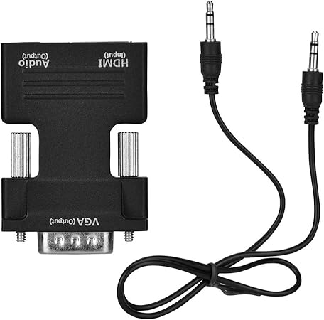

Very interesting. I don't have a graphics card with VGA or DVI-A(nalogue) in my modern PC and if I find some space for my CRT, I would connect it to my retro rig 😀
I have been tinkering with a VGA-HDMI adapter 61ft1dP1VQL._AC_SY450_.jpg but a lot of lower resolutions and odd refresh rates are not supported.
I am curious to know how well these adapters work. From what I have read, there is nothing technically stopping someone from using HDMI with a VGA DAC from doing the same thing.

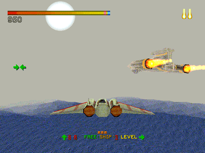

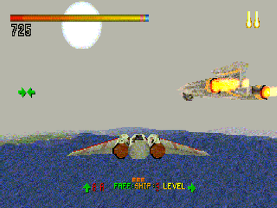

Here's a curious example I've run into recently, a demo of StarFighter 3000. You can switch between 320x200 and 640x480 literally on the fly, and here's a comparison:
The attachment star03_028-640.png is no longer available
The attachment star03_029.png is no longer available
You can see that while all sprites, including the sun disk in the sky, get over-stretched vertically in the aspect-corrected low-res image, the shapes of the 3D ships actually match the high-res version, while without correction they'd look vertically squashed.
