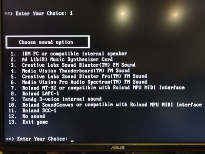

The original 1988 Tetris had PC speaker only. The 1992 Tetris Classic has up to 11 sound options:
1.38 MiB
1068 views
I've never played the 1991 Super Tetris though.
