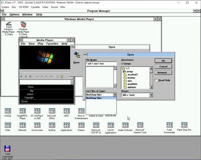

Reply 84 of 105, by Bco1981
vkcpolice wrote on 2022-04-15, 10:51:
ive never really had any issues changing drivers of updating graphics cards or sound cards. the only main issue i have with win […]
the only main issue i have with win 3.11 is that either media player 5.2 or its installed video for windows corrupts a lot of windows 3.11 dll files and the only way to fix it is to format.
i dont know if its media player 5.2 or the video for windows that causes the dll file to become corrupt
i know there was a heap of software for win 3.11 but i think i have most of it.
the only next thing i want to do with this build is get it online 🤣
Firstly, sorry about your loss, i hope you can get it fixed somehow.
I find it odd you are having these issues with mp5.2beta. i have had it installed many times and it never gave me any trouble.
Even within the last two weeks, i have installed it a couple of times on new installs while testing PCem making various pc setups.
Finally making a P100, 64mb ram, S3Trio64V 4mb, voodoo1 4mb, SB16, RTL8029AS. (pentium 100 because my old Core2quad Q9650 could emulate that when overclocked to 3.6Ghz and Intel SpeedStep disabled)
install dos 6.22, wfw3.11, make a swapfile on the suggested size, enable 32bit file access, change cache size to 4096kb.
install video driver, audio driver, add MS tcp/ip. win32s v1.30c, Wing, Video for Windows 1.1e.
now media player 5.2 beta.
And everything else.
Also, total commander 16bit v6.58 can read long file names on current ftp servers.
And just found PuTTY v0.76 win32s port. works perfectly just very very slow at generating hostkeys. (pentium 100, so ofcourse it's slow as f')
Can't remember if it was mentioned, but software i like to use is Paint Shop Pro v3.12 and Mod4win

Reply 87 of 105, by Bco1981
@vkcpolic You are doing something wrong. it works fine.
I wrote the order to go by when you install windows 3.11, never fails for me.
But other then that. mp5.2 is not really useful. It can't play wav, mid or mpg files. only asf, asx, nsc and netstreams. which... there arn't many of.
