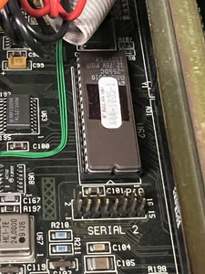

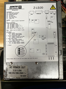

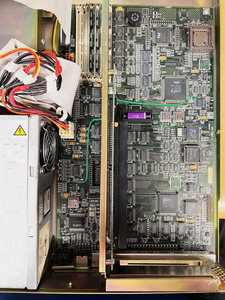

Reply 4 of 9, by ajacocks
Here's what the board looks like:

- Alex
