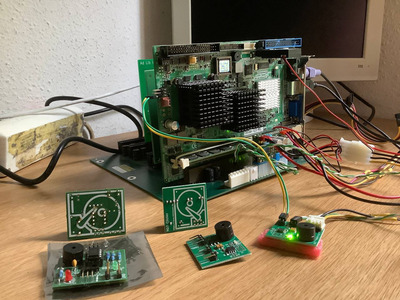

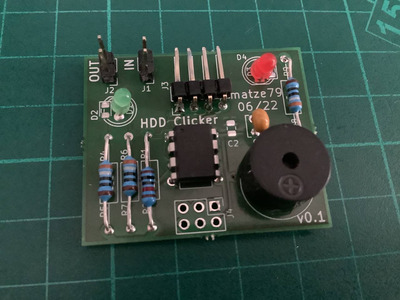

Hi,
i want to show up a small project i`m working on in the past weeks if i have some free time beside my non Computer related Job.
This is acoustic feedback for SSDs.
Prototype HDD Clicker v0.1
The attachment clicker4.jpg is no longer available
https://www.retrokits.de/index.php/hdd-clicke … simulator-v0-1/
https://www.youtube.com/watch?v=FVXRblGSSHo
HDD Clicker v0.2
The attachment clicker1.jpg is no longer available
The attachment clicker2.jpg is no longer available
The attachment clicker3.jpg is no longer available
https://www.retrokits.de/index.php/hdd-clicker-v0-2/

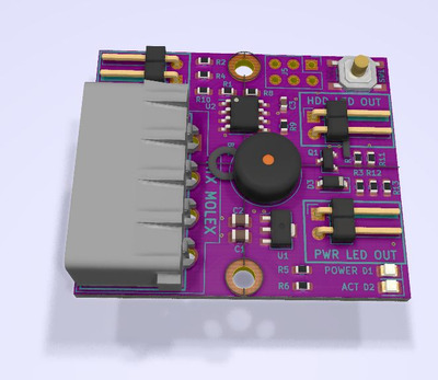

Reply 7 of 129, by dreamblaster
Coming soon in serdashop indeed, in a version directly pluggable on hdd molex power
Thanks Matze for great cooperation

Reply 8 of 129, by Jura Tastatura
dreamblaster wrote on 2022-09-19, 18:49:
nice, gonna buy that for sure! 😁
does it have an on/off button? will it be able to simulate different hdd models (with different sounds)? why does it have power led out? 😀
Reply 9 of 129, by TrashPanda
Jura Tastatura wrote on 2022-09-21, 11:23:
Lets you connect the HDD led to it from the PC case since you cant see the onboard one when the case is closed.
Reply 10 of 129, by Pierre32
TrashPanda wrote on 2022-09-21, 11:32:
It's got HDD LED out and power LED out. I've actually got one Socket 7 system that doesn't have a power LED header, so I'd make use of this.

Reply 14 of 129, by matze79
There is no SpinUp Sound.
Buzzer isnt made for sounds with deeps.
It would require a bigger speaker and some big iron mcu with few kb more.
Even a arduino is too small. It only holds 2,8s Audio at 11Khz.
Playing Spinup, Spinning Sound and Clicks would require some Sort of mixing, and a decent Speaker
At least some small ARM Cortex.
Sorry for grammatical errors, i`m not native english speaker.
