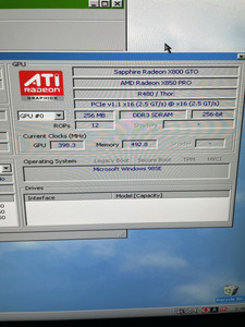

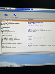

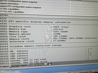

I bought an ATI X800 GTO on ebay but it is detected as ATI X850 PRO? Did they make any modifications?
Yet the vendor ID and device ID are those of the X800
It looks to me like a "mix" situation where some of the parameters are from the X850 and some from the X800
3D Mark 2003 SCORE: 9700

Reply 3 of 8, by Sphere478
12 rop
It’s not a x850
But you may be able to mod it.
The ram probably isn’t as good as a x850 though

Reply 5 of 8, by Sphere478
The Serpent Rider wrote on 2023-01-17, 15:44:
X850 Pro has 12 pp.
🤔 forgot those existed.
