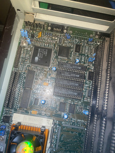

Hey everyone, I have been attempting to get the L2 cache to work as I have installed it in the correct orientation and know that these chips have been tested to work. I went to turn off the cmos battery for ten minutes, played around with the jumper settings. I am clueless how to remedy this.
The cache in question is 256k L2 sram

Hello,
I never heard of "MAGIC" 64kx8 sram chips. Are you sure these are not fake?
Where did you test those chips?

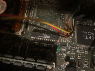

I read that you have a lot of 32kx8 sram chips.
If yes, remove those Magic chips, and put 4 times 32kx8 inside instead in order to check if 128kB is working correctly!
Reply 5 of 7, by AvocadoLongfall

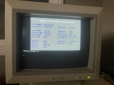

I have received the dip22 chip. Once Installed it next to the tag ram, the cache was detected and shows 128k. Man does the computer feel quite a bit faster and more responsive.
Reply 6 of 7, by CoffeeOne
AvocadoLongfall wrote on 2023-03-02, 02:15:
So you did remove those "Magic" chips? And put back the 32kx8 chips?
