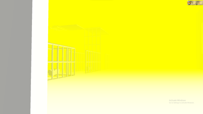

@Geri, I was testing Abashera Revamped with TitaniumGL and it has problems. Can you check out what's up with it? Its a free game accessible here: http://www.caiman.us/scripts/fw/f2203.html
A screenshot for reference:
    55.6 KiB
    1420 views

I will put the game to the test software pack, and will take a look when i will create a next version.
It could be a strange texture format which causing the problems, or it could be a missing texture state bit somewhere.
I will debug it, and if its a simple fix, i will patch it.
