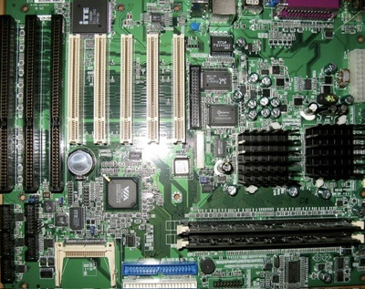

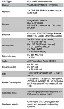

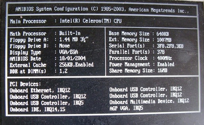

Reply 10 of 54, by Babasha
Full size ATX with ultra low voltage CPU and CF-slot, ISA.
    24.09 KiB
    1997 views
    90.89 KiB
    1997 views
    132.49 KiB
    1997 views
