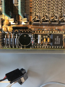

I have this FIC 486-GIO-VT board without cmos battery so I figured I‘ll just grab an external 3 x AAA battery holder…
Turns out the board has a jumper for internal/external battery. Too bad you can‘t set the jumper to 1-2 because there‘s a cap blocking it.
Any ideas how to bridge pin 1-2 without crazy bending and soldering?
It‘s J3, jumper is set to Internal Battery 2-3.
Looks like the original coin cell holder was removed at some point, there‘s some solder tin left in the holes.
I wonder why. But I do have a CR2032 holder from some scrap board which I could use.

Remove the plastic "case" on the jumper and bend the cap slightly and queeze in the jumper in there?
Reply 2 of 9, by majestyk
Just bend the two tantalum capactors to the left - gently.
I have a couple of GIO-VTs and there was always enough space for the jumper.

It‘s J3, a 3 pin header currently set to pin 2-3. You can clearly that there is no room for a jumper between the tantalum cap and pin 1. Bending the cap is no option, it won‘t move at all because the legs are too short.
I‘ll try stripping a jumper .

I didn't saw the third pin on J3, sorry. Just bend slightly the two tantalum caps to the side so the jumper will fit or bend the pins 1 and 2 of J3.
But I think there's a chance that position 1-2 on J3 is just a "holder" for the jumper and pins 2 and 3 on J3 are in parallel with pins 2 an 3 on the J1. Check the schematic with multimeter in continuation mode.
This would be true for larger cylindric electrolytics. Tantalums become narrower at the bottom end, so they can be bent easily. I have done that hundreds of times.
Reply 9 of 9, by Kouwes
Yes you are right. I was too cautious I guess because that wouldn’t be the first cap I break off a board. The jumper now sits on 1-2 so all good!
