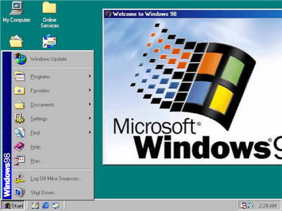

I have this computer, the image produced by the video card has this strange horizontal effect (out of sync?), the attached image I created in photoshop to accurately illustrate the problem. I can also notice a "morié?" ghost in the image.
Facts:
- I'm using an LCD LED monitor in perfect condition, the problem is not with it.
- I already changed the VGA cable
- The graphics adapter is a Mach 64CT onboard from an Intel advanced/(AS?)
- This board is using a low quality ATX power supply connected to an AT adapter (maybe it's a problem with the power supply?)

Look for broken/damaged caps around the chip and the d-sub connector.

I bet image is perfect on CRT because those used analog circuity for syncing. LCD monitors scaler will analyze one line of video to determine horizontal timing and will stick to it no matter what. Video adapter might fluctuate horizontal timings slightly, it would be invisible on CRT.

Pixel clock phase problem. Could be an issue with the RAMDAC/Clock generator for the VGA chipset. See if your LCD monitor has a phase adjustment.

Horizontal banding/artifacting is classic pixel clock phase issues with analog vga input to LCD monitors. Auto adjustment often fails to correctly recover the pixel clock.

Thanks again! (Auto-adjust was the ticket to lock in the phase and control per task/application.)
