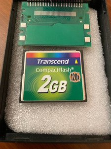

I recently purchased an IBM Thinkpad 370C and would like to replace the IDE with a Compact Flash.

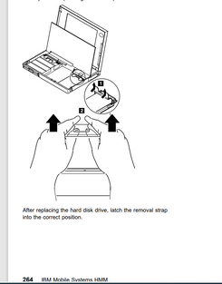

I took the hard drive out of the laptop, but I don't know how to open the caddy. In the manual,
https://thinkpads.com/support/hmm/hmm_pdf/tpvol2.pdf
I only see an explanation how to take it out of the laptop, but not how to open the caddy,
The attachment Capture.PNG is no longer available
Here are some photos of the caddy,
Could someone point out if there's a manual with this information or give me some guidelines on how to open it? I would prefer to avoid opening it blindly and just touching whatever I need to touch.

Reply 1 of 8, by DamienC
Had a bunch of these years ago and I'm going off memory but try this:
The top label is covering a pair of screws. Peel back the label slightly and remove the screws, there are nuts in the other side that will fall out too.
Then IIRC, you can get the rest of the caddy apart by carefully prying the plastic tabs away on both sides. I don't remember this requiring a lot of force so just do everything gently.

The compact flash I am using is this one, 16GB version:
https://www.silicon-power.com/web/zz/product-CFI320
The CF to IDE adapter is a generic one :
https://www.ebay.fr/itm/303108372252
When I connect the adapter to the PC, 6 pins are not connected, maybe I have chosen the wrong adapter?
There's a jumper on the CF to IDE adapter, not sure if it may be useful :
It states that Jumper 1-2: Master/Slave and 2-3: Slave/Master. Now I am just trying to understand what position is set, on the back there are no numbers :
Before trying to replace the Hard Disk, there was already an IBM DHAA-2405 running PC-DOS without any problems.
In the Compact Flash there's a FreeDOS 1.3 installed. It was installed through VirtualBox which created an image of the disk, .vhd and I just "burned" it into the compact flash. When I connect the Compact Flash, I get stuck in during the boot, I can't even boot from the floppy disk, however if I disconnect the compact flash, I can again boot from the floppy disk.

Reply 3 of 8, by Bondi
I think the problem is the CF card. These Thinkpads usually work with drives no bigger than 8Gb iirc, maybe even smaller. So I'd try another card. Mine works with a 2 Gb CF. The brand of the card also matters, it sometimes gets tricky to make them working.

Reply 4 of 8, by MikeSG
Try a 2GB formatted with FAT16

Reply 6 of 8, by waulu13
Thank you for the replies.
I tried a 2GB formatted with FAT16 on the same disk CF 16 GB but it didn't work.
I have a friend who might be able to lend me a CF 1GB. Otherwise, I think I'll just use the hard drive, as I don't want to spend money on CFs at the moment until I get one that works.

Reply 7 of 8, by Bondi
Here's the one I use. What can also matter is how you create the partition and make the card bootable. Try doing it from scratch(delete existing partition, create a new one, format/s) on the oldest computer you can. Ideally in pure DOS.
The attachment IMG_1451.jpg is no longer available
EDIT: I use the same CF/IDE adapter, and the jumper on mine is set to the same position (closer to the IDE pin header) as on your photo above.

Reply 8 of 8, by waulu13
Thanks Bondi.
Tried to create the partitions again and format as you suggested but no luck. The oldest PC I have available is from 2017.
In the meantime my friend lent me a Compact Flash EMTEC 2GB 80x and it worked perfectly fine =)
Well, I still need to find one for me but I would say the problem is solved.
