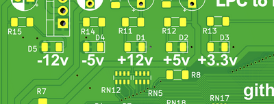

BTW: A question about the -5V and -12V rail LEDs... On my v0.2 build these LEDs didn't work even though they were indeed correctly oriented (to be precise, the opposite direction of the positive voltage ones which are working), yet the PCI/ISA debug card I used for testing did pick up -12V from the ISA slot so the rail itself is probably okay (the card doesn't have -5V so I'm not sure about that one). I wonder if these negative volt rails require some special types of LEDs than normal ones...
Reply 224 of 1108, by weedeewee
LSS10999 wrote on 2023-11-12, 08:35:
No, leds just need to be correctly oriented.
You would have positive to the anode, and ground to the kathode
for negative voltage you have ground to anode, and negative voltage to kathode
if for a moment you look at the negative voltage as ground, then you see that the original ground is higher in potential, thus showing the correct orientation, from high to low.
+ -|>|- gnd -|>|- - (and a resistor for current limiting :-p )
Do not ask Why !
Reply 225 of 1108, by rasteri
All the LEDs should point the same way, ironically I did that so people wouldn't have to second guess the orientation... Kicad's default libraries are horrible.
The negative end points towards the ] shaped bracket on the silkscreen.
On the attached picture, positive is left and negative is right, for all LEDs.

Reply 227 of 1108, by LSS10999
rasteri wrote on 2023-11-12, 14:29:
All the LEDs should point the same way, ironically I did that so people wouldn't have to second guess the orientation... Kicad's […]
I followed the + mark on the PCB when soldering the LEDs... if all the LEDs are to point to the same direction then I've soldered the negative ones wrong...
It's not trivial to rework the LEDs at this point... so if the negative volt rails themselves are working without issues... I'll keep it this way for now.
Reply 228 of 1108, by rasteri
LSS10999 wrote on 2023-11-12, 15:08:
v0.3 is going to have better diode markings, as well as orient the capacitors so they're all pointing the same way too. Is this clearer?
Reply 229 of 1108, by LSS10999
rasteri wrote on 2023-11-12, 16:05:
I think this should be good enough to explain the LED orientation (that all 5 should point to the same direction). After all, the + mark on the PCB is misleading in your case.
