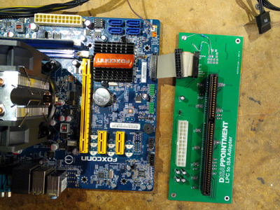

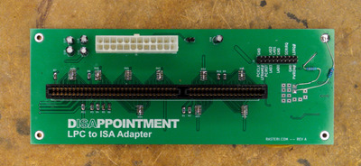

Disappointed that your modern PC doesn't have ISA?
Well - you've been lied to. Your motherboard does have an ISA bus, but it's locked away inside the chipset. And we can help it escape through the TPM connector.
I've designed an adapter that uses the Fintek F85226 LPC-to-ISA bridge to allow you to connect ISA cards to (theoretically) pretty much any motherboard, as long as it exposes the LPC bus somewhere and has a legacy BIOS or CSM.
And yes, DMA is fully functional!
Currently only works on baremetal DOS (probably linux too) but I'd love to see if a soundblaster driver could be written for Windows 11 😀
So far I've tried a Socket 755 motherboard with a Quad-core Xeon X5470, and a Socket 1155 motherboard with a 2nd gen Core i5, both work. The software should work on later Intel chipsets too, and may be portable to AMD. I wonder what the fastest possible DOS gaming PC is...
Video of it in action : https://www.youtube.com/watch/IXr-VEpQ1lg
Source code and hardware design files will be open sourced ASAP. Hopefully together with SBEMU this will make baremetal DOS gaming cool again 😀
Confirmed working motherboards :
Foxconn H61MXV
GIGABYTE Z77X-D3H

Grzyb wrote on 2023-03-19, 15:30:
For full functionality, it needs a chipset with DMA support, right?
Or that LPC-to-ISA bridge provides DMA even if the chipset doesn't?
Yeah it'll need a chipset with DMA. I haven't really looked into exactly how "modern" you can get before the LDRQ signal starts disappearing from LPC - I'll check into it at some point.
EDIT : DMA exists at least as of the 9 Series PCH, so potentially Haswell CPUs would be usable. I've not looked at AMD yet.

Reply 10 of 1119, by LSS10999
Excellent work! Does this adapter work out-of-box, or that it needs some configuration similar to that of RUBY-9719VG2AR?
From the looks of it, it might be very straightforward to install it into a standard ATX case with a MATX (or ITX/DTX) motherboard, which would make things easier.
EDIT: Looks like some initialization is definitely needed. Given the adapter can work as intended, it seems on a good amount of boards, the TPM connector does expose LDRQ/LDCK signals.
Reply 11 of 1119, by rasteri
LSS10999 wrote on 2023-03-20, 04:44:
Yeah it does. A while ago I rewrote Tiido's RubyISA utility in C - https://github.com/rasteri/RubyISA32 - and the init utility for dISAppointment is based on that.

Reply 15 of 1119, by rasteri
LSS10999 wrote on 2023-03-21, 09:07:
EDIT: This is only about the chipset. Compatibility needs to be assessed at a per-board basis, as not all boards have a 20-pin TPM header and not all boards actually wire the LDRQ signals to the header. On some boards' manuals, the pins in question are marked as NC, though it could be a lie.
Yeah if the TPM header has NC pins there's a good chance one of them is LDRQ. Often you have to add a solder bridge over a nearby resistor pad to enable it. Alternatively LDRQ can be hijacked from the Super I/O chip.
Another thing that often needs to be done is lifting the LDRQ pin of the Super I/O chip, as although Super I/Os don't really use DMA they like to hold the pin high.
I've checked some schematics for AMD motherboards and at least the X370 still has LDRQ...

Reply 18 of 1119, by rasteri
I've started a github with hardware designs and source code. Needs a lot of work still but if anyone's determined enough that should be enough to build one.
https://github.com/rasteri/dISAppointment
The "Sapphisa" utility will also work on the RUBY-9719VG2AR, and allows you to specify custom ports.
