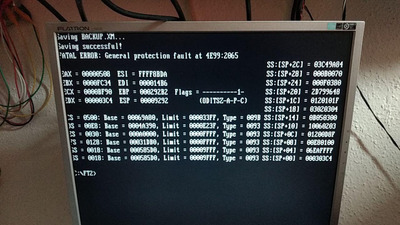

Reply 96 of 141, by matze79
39.22 KiB
2116 views
Fast Tracker 2 does not work with Dual Covox Plugs or any other Sort of Dual D/A Converters.
It also makes crackling sounds when playing MODs over single Covox Plug.
