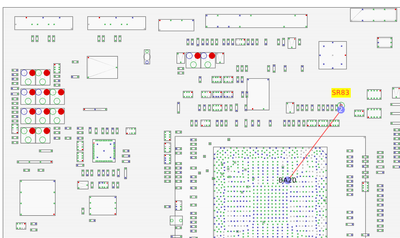

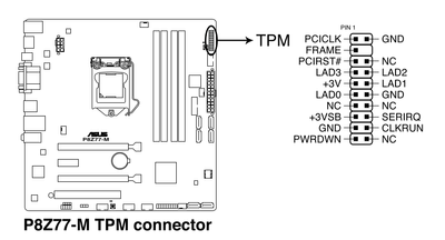

Got a Asus P8Z77-M board which has tpm header and got coreboot up and running on it, is there a chance working with LPC to ISA bridge?
Reply 107 of 916, by LSS10999
ackmangogo wrote on 2023-04-07, 04:38:
If you have the board's boardview, check where your board's LDRQ# signals are. Chances are you may need to manually solder a wire somewhere to access it. If the LDRQ# signal is routed to the TPM header thus directly accessible, then you're lucky -- it can be used without any modification.

Reply 109 of 916, by LSS10999
ackmangogo wrote on 2023-04-07, 06:35:
I'm currently using a tool called BoardViewer to look at the files. Don't know if there are any better tools, but this one is simple enough to get started.
I checked your boardview but couldn't find anything explicitly mentioning LDRQ#. Probably undocumented as there are quite a few unnamed nets (Nxxxxxxx).
At least it appears LDRQ# is indeed not routed to the TPM header for your board. You probably have to go through unnamed nets and probably chipset datasheets to determine which one might be LDRQ#.
It seems ASUS boardviews tend to have some undocumented (unnamed) nets. I looked at another ASUS boardview and it was similar -- can't find mentions about LDRQ#, but found a lot of unnamed nets.
ASRock ones are better as their boardviews do mention LDRQ#. I'm currently looking at a board (B450M Pro4-F). In this board's case, the LDRQ# is routed to the SuperIO (NCT6779D) but there are no resistor pads in between... means I'll have to actually lift the SuperIO pin in question and carefully solder a jump wire below, which certainly won't be easy.

Reply 114 of 916, by EduBat
The Asus P8Z77-M, as the name implies uses the Z77 chipset.
The datasheet for the same shows that LDRQ1# is assigned to pin BA20 and the boardview shows that pin connected to resistor SR83.
The attachment sr83.png is no longer available
So, this is where the wire would need to be connected.

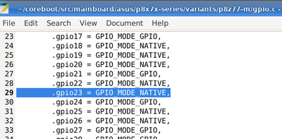

The BA20 pin can be configured also as a general GPIO but, since you mention that you use coreboot on your board, as we can see in the gpio.c file, the gpio23 is configured as Native, i.e. LDRQ1# which is excellent.
