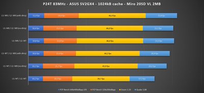

I noticed that when you compared the effect of using the L2, write-back, with dirty, that you have L1 set to write-back mode, yet in other benchmarks, you used L1: write-through mode. Why did you test the effect of L2:WB using L1:WB?
The answer is simple, i did the benchmarks in all modes. But it gives a better focus here for comparision if i only post the three values. And where yus ask here are all values with WB and WT for L1 and L2 😀
91.64 KiB
468 views
Pentium Overdrive @83MHz Cache comparision
feipoa wrote:
Normally, using the Pentium Overdrive 83 in WB mode offers a substantial boost in performance. The problem is that most 486 motherboards don't properly suport the POD in write-back mode. I recall that the Sv2GX4 wouldn't work with the AMD X5 in L1:WB mode unless you updated to the latest BIOS. Have you done this already? I don't know if it will fix the POD's L1:WB operation though (I doubt it).
As you can see in the picture above, i can confirm you, that the POD83 delivers a substantial boost in performance with L1 WB. I updated the BIOS before the buildt up to the latest official non BETA version (i guess) - to version 402.1. I read about your and vetz experiences with this BIOS version and the L1 setting to AUTO, but by had no success with L1 in WB. On the other hand saw a similar effect on the QDI, only after BIOS update it posted with the P24D in L1 WB mode (didn't try the P24T there).

I originally looked at the POD in Quake. With benchmarks starting with L1/L2:WT/WT, then switching to L2:WB (no dirty), we get a 17% increase, then switching to L2:WB (dirty hack), we get an addtional 3.5% boost. So that's a 20.8% boost total.
Still using the POD in Quake. With benchmarks starting with L1/L2:WB/WT, then switching to L2:WB (no dirty), we get a -1.9% decrease, then switching to L2:WB (dirty hack), we get a 3.3% increase (on that -1.9%.), for an overall boost of only 1.4%
Thus for the POD running its L1 in Write-through mode, in Quake, the dirty tag write-back L2 cache hack offers a 3.5% benefit over the unhacked write-back L2 mode. When running the POD in L1: Write-back mode, then the dirty tag write-back L2 hack offers a 3.3% benefit over unhacked write-back L2 mode, or an overall net benefit of 1.4% compared to L2 being run in write-through mode.
Looking now at the P24D in DOOM. Benchmarks starting with L1/L2:WT/WT, then switching to L2:WB (no dirty), we get a 3% increase, then switching to L2:WB (dirty hack), we get an addtional 0.3% boost. So that's a 3.3% boost total.
Still using the P24D DOOM. With benchmarks starting with L1/L2:WB/WT, then switching to L2:WB (no dirty), we get a -0.3% decrease, then switching to L2:WB (dirty hack), we get an addtional 0.7% increase, for an overall boost of only 0.3%
Thus for the P24D running its L1 in Write-through mode, in DOOM, the dirty tag write-back L2 cache hack offers a 0.3% benefit over the unhacked write-back L2 mode. When running the POD in L1: Write-back mode, then the dirty tag write-back L2 hack offers a 0.7% benefit over the unhacked write-back L2 mode, or an overall net benefit of 0.3% compared to the L2 being run in write-through mode.

L2: WT --------------------> WB (broken)
L1: 140.66----------------->141.67 MB/s
L2: 57.61------------------->61.60 MB/s
RAM: 47.41----------------->37.73 MB/s
The L2 results improve, but the main memory speed takes a drive.
