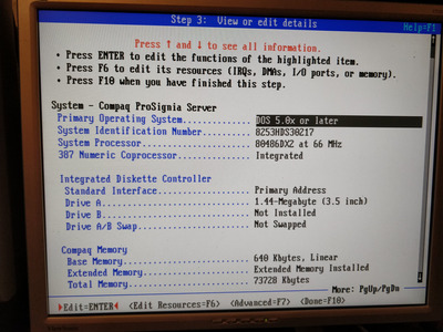

Find the softpacs needed to get to be able to change access the bios settings
Found it, installed it and I'm really impressed how well some things work.. and how bad other things work. This is my first EISA-computer and it has a lot of features that I have never seen on a 486 system before.
SP19619 contains the Configuration Software and is used to create a system partition on one of the hard drives.

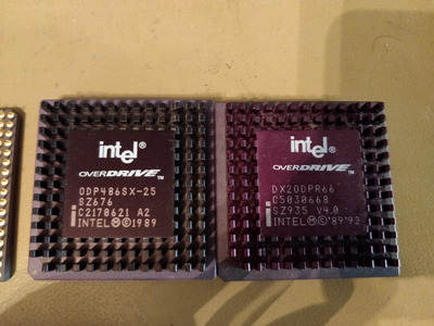

It seems to support Pentium OverDrive CPUs...
This is still on the list... But I had a 486DX/2-66 Overdrive!

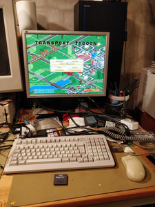

I didn't do any benchmarks before I changed the CPU but it appears to be faster now.
Install Dos 6.22 and Windows 3.11. Maybe an early version of WinNT (3.51 or 3.1)
Probably one of my messiest installs ever but it works... Mostly!
Windows NT will have to wait for a while or get installed on another 486. I have 3 motherboards that more or less is complete... and a few Pentiums.
Admire it's beauty and play some old games until I get bored and start working on another computer...
Done! Most games seems to work fine. No random crashes or other things that I can think of.

1) Yes, Pentium Overdrive 83 works, I ran mine with it. But your DX2/66 is already fine, so low priority. And yes, the machine has 256kb cache. What seems to be special is the fact, that the cache is 2 way associative, and even better the full 128MB RAM that are possible are cachable by it. That is simply a great 486 computer.

1. Nice to know and if I find one it will be perfect in this computer.

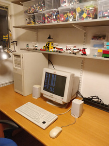

Up and running on a proper desk for the first time!
Tried some old games and had a good time 😀

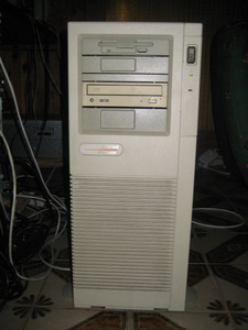

I could not resist, removed the Adaptec and put the cable to the internal controller.
Windows 98 SE automatically worked, after using FWS2ASPI.SYS and FWS2CD.SYS in config sys and changing the name of the drive for MSCDEX to CPQCDROM, reading cds also works in the dos 7.1 (the dos of windows 98se) like a charm.
Also it looks now a bit better. Using the internal SCSI controller enabled automatically the harddisk LED, there seems to be only one connector with several wires from the mainboard to the case, that obviously connects the harddisk activity led, too.

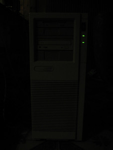

Maybe I misunderstood, I am not sure what you meant with "Connect the HDD-leds!"
Reply 50 of 57, by OSkar000
I have an extra hdd-led on the 5,25" front plate where I have one of the hard drives. I think I saw a connector on the disk (the 340mb one) for a hdd-led it should be quite easy to fix. I will have a look at it when I replace the cd-rom.
The hdd-led on the case works as it supposed to do.
