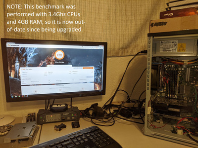

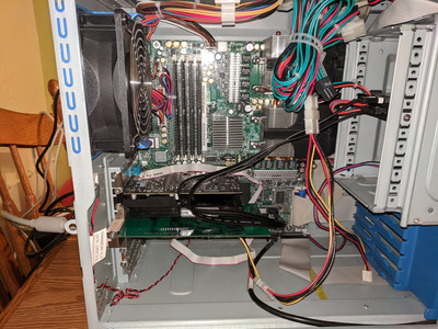

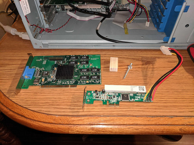

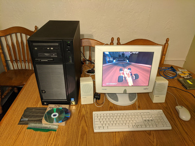

Here's a preview of my next build - this time dual socket 604!
OSes:
DOS, Windows 98 SE, Windows XP (32-bit), Windows 7 (64-bit)
Specs:
Unknown brand OEM case
Intel SE7525GP2 (Socket 604) Motherboard (PCI-E/PCI-X/PCI)
Dual 3.8Ghz Xeon (Irwindale) CPUs w/64-bit support
8GB DDR1 ECC/REG RAM
PNY 120GB SATA SSD (2x)
Unknown brand PATA DVD+RW
ZIP 750 PATA
3.5" Floppy
Nvidia Geforce 1050 GTX 2GB PCI-E (DVI/DP/HDMI)
Creative 6760 (3dfx Banshee 16MB) PCI (VGA) w/PCI-E Bridge + 2" Bracket Mount Extension (made from wood, soon to be replaced with a plastic or metal equivalent)
ATI Rage XL 8MB PCI (VGA) (built-in)
Yamaha YMF724 PCI
600W ATX PSU
Pending parts:
HD-DVD/Bluray Drive (SATA -or- PATA)
Linksys USB1000 (ASIX AX88178 w/VSC8211XVW) USB (Internalized) - Win98 compatible USB gigabit!
USB 2.0 Hub (Internal)
