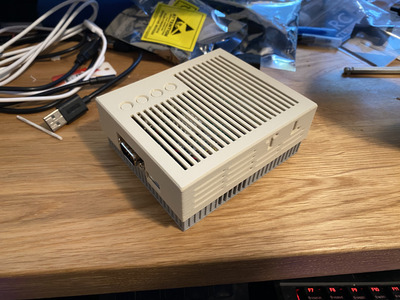

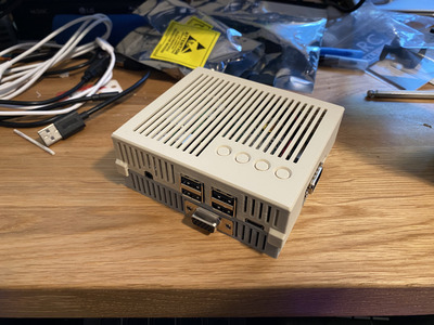

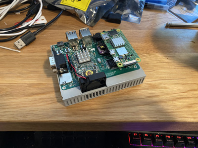

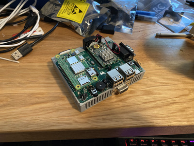

I printed the case using Hatchbox grey PLA for the bottom half and PrintedSolid Jessie 500 beige PLA for the top half and buttons and I'm quite happy with that color combo 😀 I was going for a 90s Packard Bell desktop look and it definitely hits that note. I did modify the case a bit for extra ventilation though I think I need to re-print it without the top vents opened up. I may also try to get a spot in the front for the MT32-Pi's OLED. (BTW, thanks for posting the STEP files rather than just STLs, @Eivind!) Prusa i3 Mk3, 0.6mm nozzle, 0.3mm layers, 15% infill.

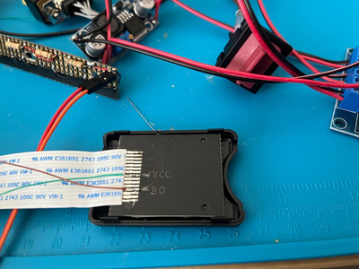

Just thought I would share that I figured out a solution for the SD-Card activity LED . Used a yellow 3mm LED (1.9-2.4V) and 1K resistor on positive leg of LED. Wired negative leg to Data0 of the SD card since the data line is normally pulled up when not operating. And positive leg to VCC (VDD pin 4) .Works great and only illuminates when there is activity. I am using an SD-card extender so that is what I wired this too, not directly to the TinyLlama PCB.
    454.29 KiB
    801 views
Reply 547 of 652, by ExplodingLemur
I wonder what the spec'd drive current is on that line? I'd feed a transistor gate with that pin rather than use it to run an LED directly just to be cautious.
Reply 548 of 652, by Eivind
Aaron707 wrote on 2023-05-23, 22:53:
That's cool! Did you experiment with using the different sd card signals and found D0 to work the best?
ExplodingLemur wrote on 2023-05-24, 01:03:
I think you mentioned using a transistor a few pages back, Aaron? However, using a LED and resistor as you described would only draw a current of 1-2mA - and since each pin's current driving on the Vortex86EX is spec'ed as 8mA (though, it doesn't talk about sourcing or sinking), I'm not surprised it seems to work just fine!

I only tested with D0 signal. I found this video https://youtu.be/SsPOobvoBe8 that described the process (in comments). Seemed much easier to implement than a transistor. Working great so far. If someone finds a better solution please share! It is hard to find much info on adding activity indicator to SD card slot outside of the RaspberryPi circles. And most others only discuss SPI mode.
Reply 550 of 652, by rasteri
With relatively high-speed devices like SD cards there's more to consider than just current carrying capacity, I would be worried about upsetting signal integrity on certain combinations of card/OS/transfer mode. If it works on your setup then great, but I wouldn't be using it in situations where reliability is important.

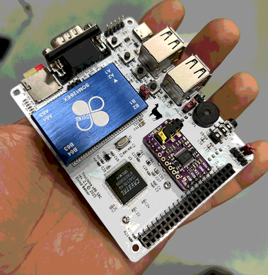

Hello everyone,

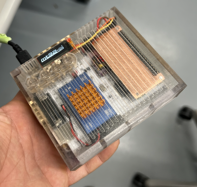

I am new to this amazing project. I got super excited about the Tinyllama 2 and I ordered the PCB in White and hand assembled all the components. Here are some pictures. Then I went with a clear resin 3D print of the box. Interestingly, I figured out to place the 0.96" OLED right about the buttons. Here are some pictures.
Special thanks and congratulations to Eivind for this amazing project.
    367.08 KiB
    584 views
    1.99 MiB
    584 views
Reply 552 of 652, by Eivind
ahmadexp wrote on 2023-05-31, 14:17:
Hello everyone,
Nice touch with the white PCB and clear case! Hope you'll get the wavetable adapter soon, if it hasn't reached you already! 👍
