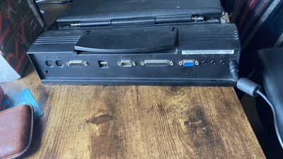

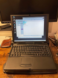

A Dell Inspiron 3000 with 266 mhz Pentium II. Just like the cool kids 😎👌🏼
It came with a massive port replicator, which, crucially, has a joystick port!

The above took me a full evening to get to. You see the point is, this Dell HAS. NO. CD. Drive!! 😩🤯
D’oh!
The two Toshibas have one, and I naturally assumed this one would, too. Oops.

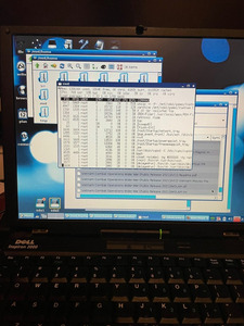

No sweat: from lurking on this forum I knew about SHUCD. It’s actually a huge help that the Dell had been equipped with a weird dual boot setup by its previous owner:
158.04 KiB
447 views
Something calls “Weary Puppy Linux”. Never heard of it!
