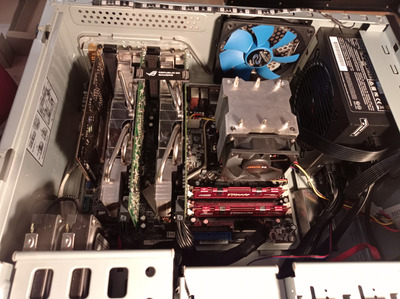

  • Socket 939 Asus A8N32-SLI (updated from A8N-SLI Premium in 2025)
  • AMD Opteron 154 (~idem Fx-57) : 1c/1t 2800Mhz 1MB L2 cache (locked mult)
  • 1GB (512 x 2) Adata Vitesta DDR500
  • 2x nVidia GeForce 7800GTX 512MB in SLI
  • Creative Sound Blaster X-Fi Platinum PCI (with front 5.25 bay panel) -> Temporarily replaced by a (non period correct) X-Fi Titanium Fatal1ty PCIe 1x (for cooling reasons)
  • Western Digital Raptor RAID0 2x 36GB SATA
  • Windows XP
  • RaidMax Smilodon Case
  • Custom cooler (air)

After dozens of experiments, (including buying new RAM, a new motherboard and a new PSU) i finally fixed the instability.
I tried :
  • Different memory brands (Corsair, Kingmax, generic)
  • Three different motherboards with the same Nforce4 SLI chipset
  • Three different CPU (3500+, 4000+ and Opteron 154) + the Opteron 180 before
  • Two different PSU (modern ones)
  • A lot of GPUs
It was apparently caused by the 4 memory sticks in dual channel.
For an unknown reason, everything works well with two sticks, while it randomly crashes with 4 on all the combinations i tested.
During this troubleshooting process, i bought a slightly different motherboard (A8N-SLI Premium), better memory (Adata Vitesta DDR500) and a brand new PSU. So this was the final upgrade.
The system now works perfectly, without any crash.

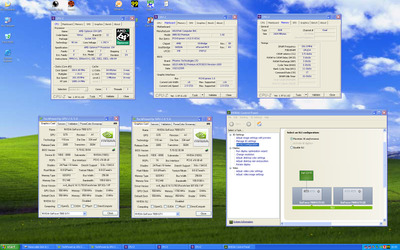

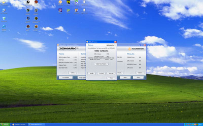

+ Adding some screenshots
The attachment Config.jpg is no longer available
(Yes, i know i'm using the DDR500 at DDR400 frequency but i don't really want to overclock. Performance is still very good and now i finally have a stable gaming machine, i don't want to ruin that 😁)
The attachment 3DMark.jpg is no longer available

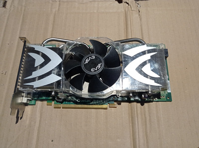

I've a pair of EVGA GeForce 7950 GT2's Cost me $50 each and came from Israel I think? This is back in 2018.
Problem is they hold back a XP build so I'm not currently using them but do want to build a rig around these at some point as well as an apposing Crossfire build.

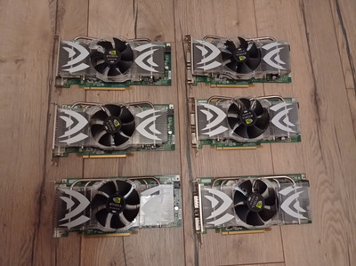

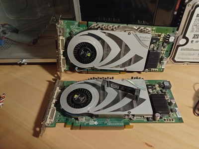

Yes, a total of 9.
Two "regular" 256MB
Seven 512MB... but 3 dead, one unstable in SLI and 3 in good shape.
I never heard of GT2. Or is that GX2 ? (The dual GPU dual PCB cards)
Reply 9 of 25, by Brawndo
chinny22 wrote on 2023-04-04, 11:26:
Same! I've a pair of EVGA GeForce 7950 GT2's Cost me $50 each and came from Israel I think? This is back in 2018. Problem is the […]
2Mourty wrote on 2023-04-04, 00:52:
I'm a sucker for any sli system. Nice work!
Same!
I'm actually doing just that right now for a 2006 mid-range XP build. In the past week I've picked up two EVGA 7950 GTs, for about $50 for both shipped (couldn't believe they were that cheap) and I'm doing an SLI build on an Intel 975X board with a Core2 Extreme QX6700. I'm just waiting on the Creative Soundblaster X-Fi Elite Pro I ordered to arrive, then I'll have all the components.
Reply 10 of 25, by chinny22
acl wrote on 2023-04-04, 21:55:
Yes my bad GX2. Quad SLI 😀 very sexy but also very useless 🤣
Reply 11 of 25, by vstrakh
That Smilodon should have a side bar, hosting additional fan and pushing the cards into motherboard with adjustable pins/fingers/plungers (can't figure the right name).
Is it missing, or dropped entirely because of high cards? 😀
Reply 12 of 25, by acl
vstrakh wrote on 2023-04-05, 13:29:
Yes, you're right !
I have the bar, but i'm not using it. (It's very thick and i don't really like how it looks)
I added a fan in the floppy bay to blow on the upper GPUs (and the front case fan blows on the lower GPU through the disk bay)
I had to tune a bit the airflow when i changed the 7800GTX versions.
The 256MB version sends hot air toward the middle of the case, while the 512MB version sends hot air in both directions (in and out)

Reply 13 of 25, by acl
An update to this build.
I finally swapped the mainboard for an A8N32-SLI.
There are some pros and some cons.
The attachment A8NSLI-premium.jpg is no longer available
The attachment A8N32-SLI.jpg is no longer available
For the pros :
  • The overall layout is a bit better on the A8N32-SLI.
  • The two PCIe 16x are shifted one PCI slot to the left. In my case this allow the two 7800GTX 512 to be in front of a fan blowing fresh air from the front of the case to the back. But this forced me to put the HDDs in the 3.5 inch rack above.
  • The "EZ-plug" (molex) that is used to add extra power to the PCIe GPUs (not mandatory but i use it just in case) is now near the ATX power connector (and not in the middle of the board)
  • The SATA connectors are more spaced. Allowing me to use 90° angled connectors
  • 8-phase power should help with OC
For the cons :
  • You can't use any PCI slot if you have two PCIe GPU in SLI with two slots coolers. Only one PCI slot is available and it blocks the top GPU airflow, at least for the 7800/7900 range cards who have the fan on the front side of the card. This sucks a lot. I tried to place my SoundBlaster X-Fi here but then there was a 15C° temperature difference between the two PCIe cards.
  • Performance gain... not spectacular in my tests at stock clock speeds.
  • I had to re-install windows because the previous install could not boot with the new board.
The attachment IMG_20250515_165443.jpg is no longer available
To address this heating issue i tried to place a fan above the GPUs, this was efficient but noisy.
As a temporary fix i removed the SoundBlaster X-Fi platinum (PCI) and replaced it by an X-Fi Titanium Fatal1ty (PCIe 1x) since the PCIe 1x slot is not blocking the airflow. This is defeating the period correctness but i really don't want the top GPU to overheat and that sound card is still an X-Fi card with the same feature set. I still can revert this and use the PCI card + the noisy cooler if i want to be "2005 only".
Another solution would be watercooling the GPUs.
I had other issues while swapping the mainboard... like breaking the sata connector of a raptor hard-drive. I fixed that my swapping the HDD board with and identical one i had around.
