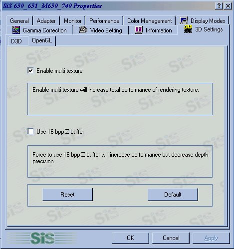

Reply 52 of 53, by CraigG
Do you mean enable it or disable it ?
I thought it should look like this
EnablePrecisionFix=0
As I read your description as saying that, if you enable this (i.e. =1) then it's because your GFX card only has a 16bit zbuffer.
So if it's set to =0 , then you will be using a 24/32 bit zbuffer.
Is that right ?
The main problem with MDK, and I think a lot of games, is overlayed text.
If you goto the joystick config option in MDK, the fps goes down to a constant 5fps, and the screen doesn't clear when you move the selection bar.

Reply 53 of 53, by GoldFinger
EnablePrecisionFix should be set to 1 most of the times, if your board supports 24/32 bit z-buffer then OpenGLide will automactily not use the precision fix. It is something like this:
if the current z-buffer is over 16bits then disables precision_fix else if the user has enabled precision_fix enables it.
Got it? 😀
