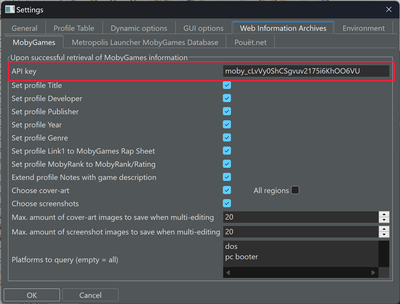

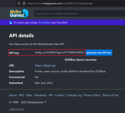

Reply 1871 of 1968, by rcblanke
Hi all, I've just uploaded beta4, fixing MobyGames queries. Note that I've switched from website crawling, to using the public MobyGames API. This (rather poorly documented) API seems a bit limited though, both in its features as in its speed. Also, it restricts the amount of requests per second, and per hour. DBGL should take care of this, but if you find you get error messages regarding HTTP429, you may want to create a personal MobyGames API key. If so, create a MobyGames account and then visit your profile page. Click the 'API' link under your user name to find your API key, and enter that value into DBGL preferences' screen.
All the latest files. Please note that a new json-20230227.jar was added, you should add it in the DBGL/lib folder.
Ronald

Reply 1874 of 1968, by dosdog
097b4 seems to be working well, though I got some 401 errors after performing several MobyGames API calls in quick succession. Am I being throttled? Would applying for my own API key help?
Reply 1875 of 1968, by dosdog
More on the above - I generated my own API key and updated it in DBGL settings, but still getting the 401 error with the new key.
The MobyGames API page says error 401 is "Unauthorized - Sent if you attempt to access an endpoint without providing a valid API key".
Could be server-side I guess...
