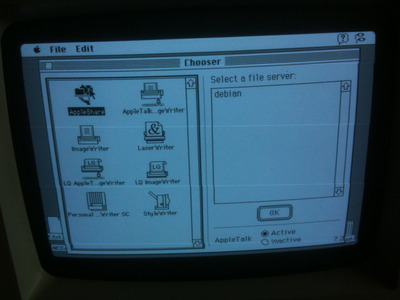

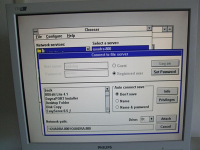

I'd just use Raspberry Pi or a Win9x VM for communication with old PCs or PC emulators.
Or use AppleTalk/AFP for your legacy network. There's a driver that works with NE2000 compatibles, too.
It supports Windows 3.1, so Win95 should be compatible with it.
Re: Best way to transfer files over a network in Windows 95?
Good luck! 🙂🤞
    496.8 KiB
    4006 views
    Chooser on an m86k Macintosh
    91.74 KiB
    4006 views
    Chooser on Windows 3.1x PC
    local_dos.zip
    815.59 KiB
    131 downloads
    Driver for LocalTalk PC cards (DOS/W31)
