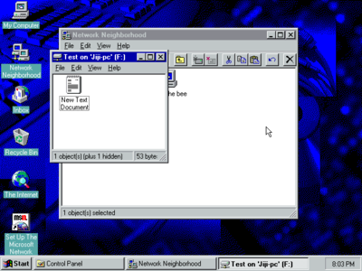

Quick update..
Connecting from Win95 (4.00.950) to a share worked like a charm..
No passwords this time, you can't expect this to work from such a dinosaur.
Tip: Also check that "Local Security Policy" thingy in Win 7. There's a lot you can tweak.

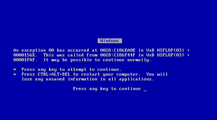

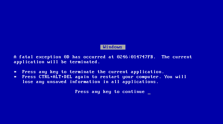

Btw, the reason I favored it in VBox was because I already had that VM ready to use and because 98SE did greet me with screens of blue.
You linked to this post in another thread and I thought I'd have a quick look-see.
I don't know if you tried this already, but a Google search for <vxd hsflop> suggests the standard Windows floppy disk controller does not work properly under VirtualBox without some persuasion.
https://forums.virtualbox.org/viewtopic.php?f … =33359&start=30
I prefer VMware Player for my Win9x virtual machines, but it's been a long time since I've messed with them.
