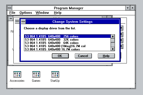

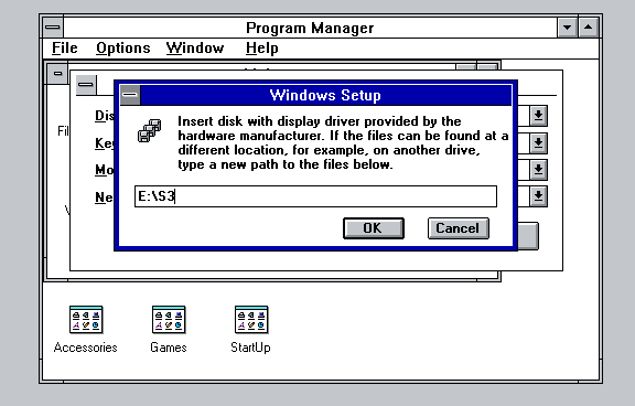

After I input the location where I have the files and select the 640x480 256 colors option, I click acept and instead of getting the restart message, it asks me to input the files location again. No matter how many times I click OK, the same window keeps popping up.

This is how the settings are.
Here I input where I have the S3 Driver files
Choose the desired display

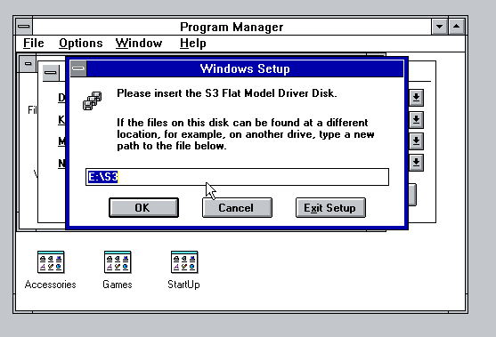

And after clicking OK this is the message I get. And if I click OK it pops up again.

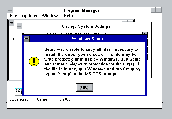

I get this message if I click 'cancel'.

Hmm, never experienced that. Please try downloading the s3 drivers from the guide and unzip those again.

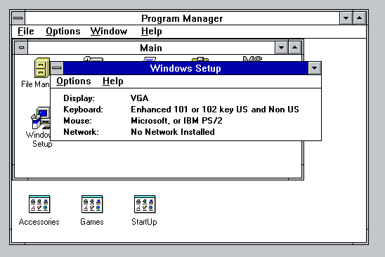

And also try from outside of Windows, meaning, quit Windows 3.1x, cd to C:\Windows and run setup. Then select the vodeo drivers in that dos program

It took a few tries but finally it worked by running setup (: thank you so much ^^
