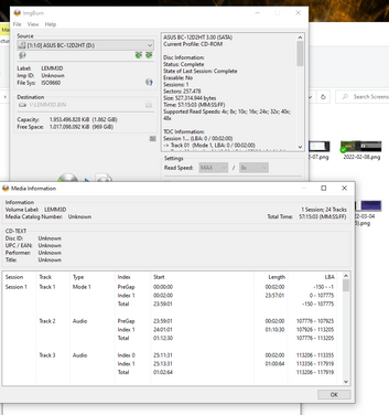

I'm trying to run Lemmings 3D from a ISO file I just built with ImgBurn. The Lemmings 3D CDROM is a mixed mode (data+redbook tracks) cd.
When just mounting the actual cd like this, I have no problems running the game: MOUNT D D:\ -t cdrom -usecd 0 -ioctl -label LEMM3D
But when I try to mount my ISO file, it either hangs or gives the error 'Illgal GRP4 Call 5'. This is the command I use for the mount: imgmount D: <path to file>\LEMM3D.cue -t iso
Is this a problem with DosBox? Or is ImgBurn giving me a corrupted ISO? It gave no errors when reading the cd, and after the iso mount I can view the files on the D drive.

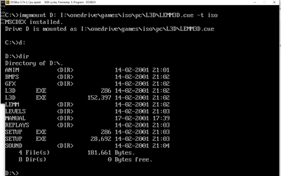

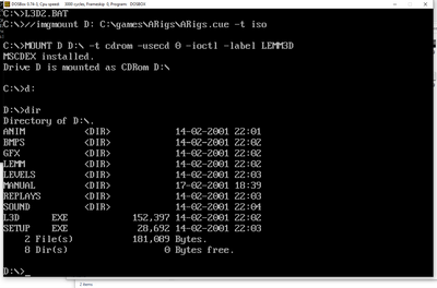

The problem is in the data track it seems, I just noticed that the .EXE files in the directory listing are doubled..I added a screenshot of the ISO mount and the normal cdrom mount.
I also added the CD track info from ImgBurn.
The disc in question appears to contain associated files, which in most cases are Macintosh resource fork data. Lemmings 3D is a DOS game released in 1995, so the 2001 dates in the directory listing suggest the disc is re-authored rather than original, perhaps accounting for how resource fork data got into the file system. In any case, you will need an SVN build of DOSBox to avoid the issue when mounting the image with IMGMOUNT.
