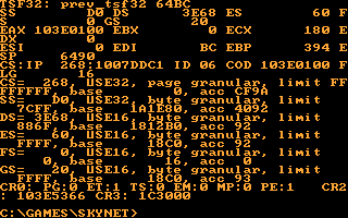

I need help running TS on dosbox but i want to replace dos4g with dos32a but it wont work. Tried sb /b /r skynetw.exe and sb /r skynet.exe but it wont work. Shows me this after crashing:

Maybe there's something in the executable that checks whether it has been modified?
I think you can run the game with DOS32a just by typing "dos32a skynetw.exe" without using sb.
Reply 2 of 19, by comteck123
Nope. Still crashes but this time Dosbox did fully crash. Also I am doing this because when I load the save game for like multiple times it just crashes and says DYNX86 can't run code in this page.

Reply 5 of 19, by Jorpho
And the same thing happens when you don't use DOS32a?
Anyway, using core=normal in your dosbox.conf might be worth a try.

Reply 10 of 19, by Jorpho
"DYNX86: cannot run code in this page" implies a problem with the dynamic core. That is why I suggested using core=normal in your dosbox.conf . Have you tried that yet?

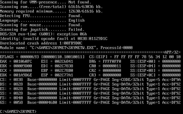

I tried it and after a few loads I get this:

Reply 13 of 19, by Jorpho
comteck123 wrote:
You say it happens "after a few loads" but your caption says "I always get this everytime", so which is it?
Also, does that happen with both dos4gw and dos32a?
Reply 15 of 19, by comteck123
Jorpho wrote:
comteck123 wrote:
I always get that everytime I load my save game a few times. And it happens in both Dos4gw and dos32a but with the latter, it immediately crashes after I reload my save.

Reply 18 of 19, by OokOok
The referenced patched executable didn't do anything for me, but what did work was to strip the embedded DOS/4GW (using DOS/32A's "sb" tool) and then run the game through DOS/4GW 2.01. It's been completely crash-free after that, even inside the toxic plant in Future Shock, which crashed every five seconds otherwise.
Reply 19 of 19, by comteck123
Also I can play the game crash free using the emucr.com svn builds of dosbox. Just make sure you have fixed cycles around 60k or it will not work
