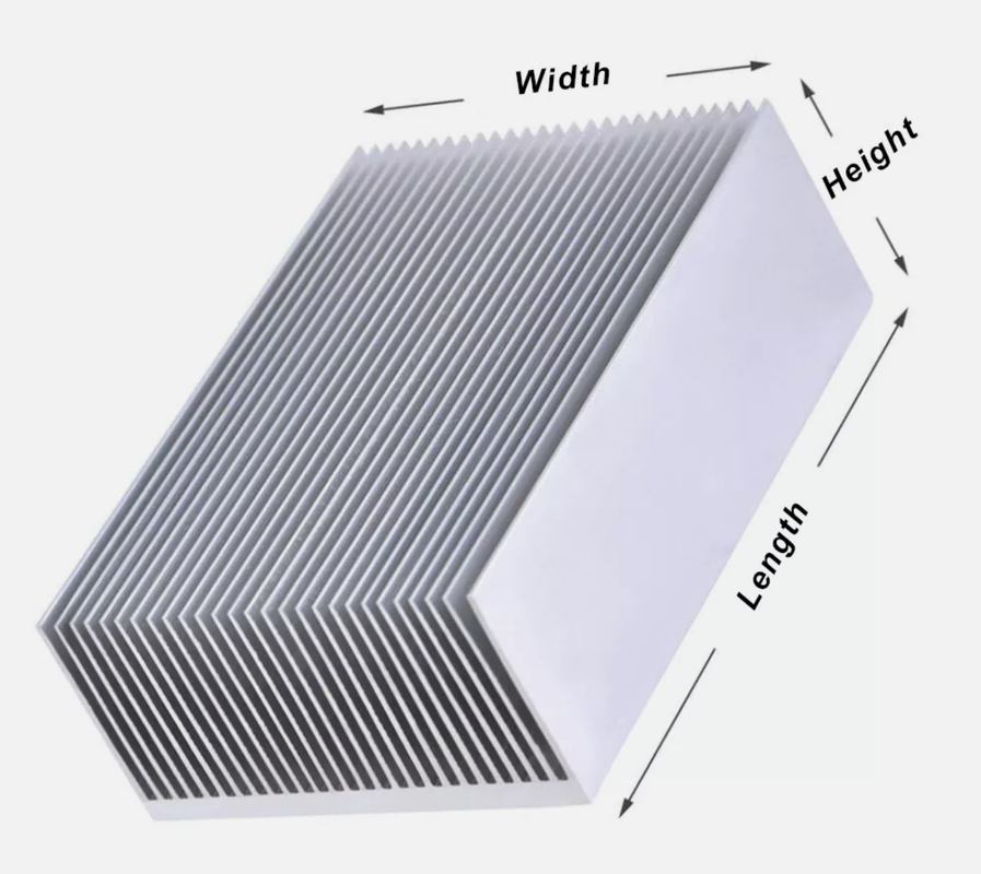

Reply 17 of 24, by Omarkoman
sorry to revive an older thread but would this work ok on the AMD DX4 100 Mhz ? And how would you mount it ? with a thermal glue (not ideal)?
2025-02-08-06-39-10-Aluminium-Heatsink-With-Without-Adhesive-CPU-Electronic-Computer-Electrical-Cool.png
dimensions are 46mm x 46mm x 30mm which is 1mm over the size of the CPU but that should be ok.
Would I need a fan for it ?
Reply 18 of 24, by MikeSG
If you live in place where summers are hot, and you intend to run the CPU at 100% for long periods of time it needs a fan...
I bought a DX4-100 ODPR recently that was permanantly damaged and no longer worked stable at 100Mhz. Overheat/overvolt damages them.
Modern thermal pads and thermal glue is enough IMO to transfer the heat. They gain 1-5 degrees per second only. Modern CPUs gain 10x that.
Ebay has many 40-45mm heatsink & fan combos. A case fan blowing air directly on it would work too.
