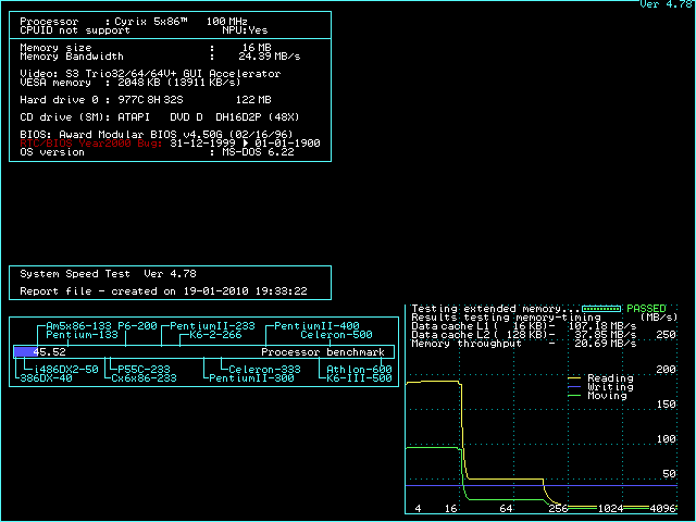

I've got a problem with the mobo's cache. The board was supplied with 128K of cache, and a TAG chip. That configuration works. Now, I have added 128K more cache, to make 256K. That configuration makes the mobo very unstable. Here's the technical info -
Bank 0:
4 chips, all marked:
W24257AK-15 (14 metal legs)
95451
TAG:
W24129AK-15
95220
This 128K config works OK.
Now, I added 4 chips to Bank 1:
W24257AK-15 (14 metal legs. Also, same code as above.)
94490 (Different code to above.)
This 256K config is not stable. Please note - I changed the mobo's cache jumper settings from 128k to 256k. Do I need to change the TAG chip? Also, I have some more W24257AK-15 (14 metal legs) chips I could try. Also, I have 4 larger cache chips, with 16 metal legs. These 4 chips have these markings:
W24M512AK-15
94521
Thanks a lot for any advice.

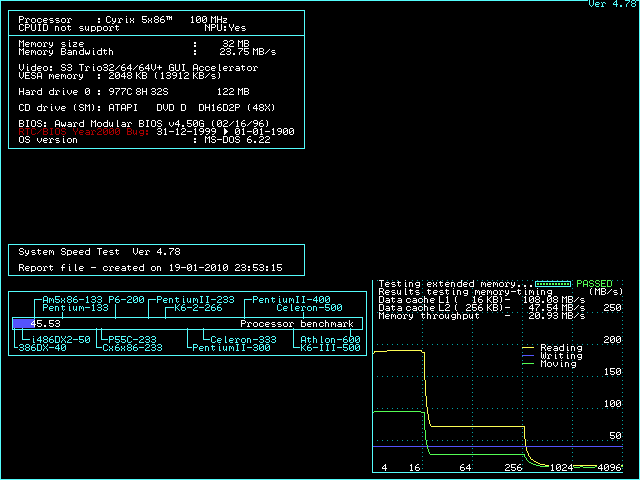

Edit: Solved! I removed the existing TAG chip marked:
W24129AK-15
95220
And replaced it with a (same sized: 14 legs) chip marked:
W24257AK-15
94490
In fact, this replacement TAG chip is the same chip as the 4 new chips used for Bank 1, in order to increase the cache from 128K to 256K.
Benchies will follow soon...
Edit 2:
I have temporarily misplaced the Matrox card. I will definitely find it, and rerun speedsys. For now, I have rerun speedsys with the extra mobo cache of 256k. Also, I upgraded the RAM from 16MB to 32MB. I don't know what type of RAM it is. It probably isn't Fast Page. Also, I maxed out the advanced chipset BIOS settings. So, I set cache to "turbo", and RAM to "fast", etc.
    6.83 KiB
    3982 views

This is odd. Why are the pcpbench scores so bad on this mobo? I wonder if the advanced chipset BIOS settings are to blame? This thread seems interesting -
Finally!! A stable Socket 3 System!!
On page 2, Vogons user "2Mourty" says that if he changes the L2 cache setting, then the memory bandwidth increases. Amigaz, you then reply with "Weird...welcome to the world of buggy'n'crappy socket 3 mobo's" Hehe!
If you look at my speedsys screenshots above, the memory scores are poor. I might mess about with the advanced chipset BIOS options, and see if I can improve things by decreasing/lowering the current "aggressive" settings...

Reply 17 of 40, by retro games 100
I ran this, on the command line: doom -timedemo3 demo3
Comparison benchmarks (and timedemo instructions) can be found here:
http://www.complang.tuwien.ac.at/misc/doombench.html
My "realtics" score is 2087. By comparison, someone else scored 2086, and their system is:
AMD486-100, 8KWT, Hippo DCA 2, 82C802G 33, Quadtel PS805, S3c805 VLB, 2M DRAM, MB uses EDRAM
