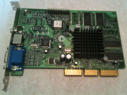

I'm going to test an Aopen TNT2 AGP VGA card. Its model is PA3000 /PLUS. The nVidia website has old drivers dating back to about 29.something. OTOH, DriverGuide has a driver dating back to a version number of about 12.
I would like to test various driver versions, to see which gives the best performance. Can someone recommend an old detonator driver I could try, and where to get it from please? For the oldest driver, would version ~12 be sufficient? Or are there others I could try which are older than ~12, and also driver versions between ~12 and 29.something. Thanks a lot.
Image below is random photo taken from the net. I'll take a pic of mine tomorrow...

I'm testing an nVidia TNT2 Aopen PA3000 /PLUS 32MB AGP VGA card. After every test in the benchmark results table seen below, I ran DriverCleaner 2.7 (for Windows 98 ) to remove all traces of each nVidia driver package. I also rebooted the machine between each test. The test machine is: Epox KT133A, XP-M 3000+ running at ~1.6GHz, 256MB, 133 FSB.
The card
The card's POST BIOS info
Everest ultimate information
64-bit? That's a pity. So many of my TNT2 cards are 64-bit!
Vanta tab & other properties
These screenshots are taken using the oldest driver version, version 1.2; "4.11.01.xxxx" (from the readme.txt file) - the xxxx is 0120.
