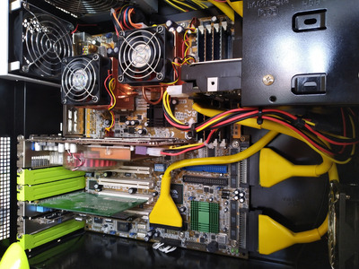

Reply 302 of 311, by MadYoshi

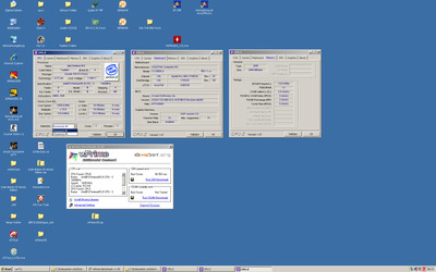

Boards with an Apollo Pro266(T) are realy rare. At that time Intel wanted to push the P4 and Sockel 423/478. So they gave the sockel 370 and the Apollo chipset with a Pentium III-S no attention. For my ASUS CUV266-DLS i can say, the AGP performance is normal.

Reply 303 of 311, by Meatball
MadYoshi wrote on 2023-01-19, 22:39:
Boards with an Apollo Pro266(T) are realy rare. At that time Intel wanted to push the P4 and Sockel 423/478. So they gave the so […]
Now that is a nice, impressive, looking interior!
Reply 304 of 311, by Sphere478
Seconded, very nice! Impressed!
Sphere's PCB projects.

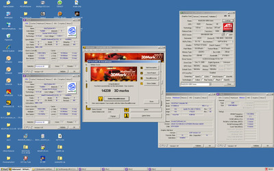

Reply 305 of 311, by Standard Def Steve
Holy hell dude! You beat the PIII-S 3DMark01 score I've been bragging about for years, and at stock CPU clocks to boot!
Yep, 266T is the only VIA P3 chipset with up to par AGP.

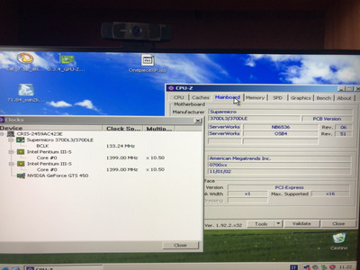

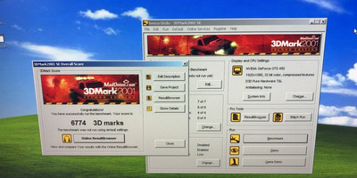

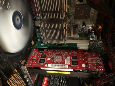

I am playing around a Supermicro 370DLE.
Got two LinLin and a pair of SL5XL.
No AGP for me so I am using a PCIe to PCI adapter (I would love a PCIe to PCI-X one… Anyone??).
Using a GTS450 LP card for it has external power, so power delivery of pci slot is not an issue.
It works, but bandwith is pcie x1 and 3D Mark result is showing (6700 points)
Reply 310 of 311, by Skorbin
Actually your GTS450 is running at a slightly slower speed: PCIe 1.0 x1 already can do 2,5 Gbit/s, while the Adapter probably could use maximum 66MHz/32 bit from the PCI-X bus, in which case it would be limited to 2,133 Gbit.
But this is still way better than my HD5450 PCI in my TYAN S2505t, as the PCI bus there runs at 33 MHz and the graphics card shares the bus with all other PCI components.
Anyhow, my system managed to get 6700 3DMarks in 2001 SE as well, so I assume that your adapter actually uses 32 bit as your graphics card should be way stronger than mine.
But I think that my system will be getting noticibly slowdowns if there is a lot of PCI activity in parallel (network card, harddisk access, etc).
Reply 311 of 311, by Mamba
Skorbin wrote on 2023-05-31, 12:40:
Actually your GTS450 is running at a slightly slower speed: PCIe 1.0 x1 already can do 2,5 Gbit/s, while the Adapter probably co […]
Nah… It was a bad bridge I was using.
