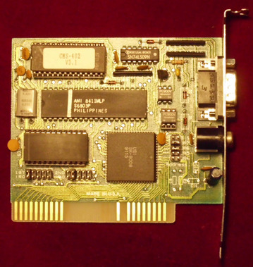

So sorry I forgot about all this.
Still have the CMS-401 II.
Still someone listening in here?
Photos of card and box. In what I'd consider "high res" for internet standards.
(Not sure what this forum supports as attachments, don't like upload portals for linking too much, but recommendations welcome.)
4th Chip didn't quite make it in the picture, it reads
RCA X
CDM6116 AE2
441
Card came bundles with cakewalk 5.0 for Dos on 5.25 and 3.5
There also was something really weird and boring. A hardware manual. Enjoy.

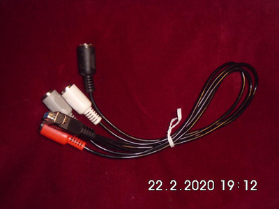

Quick & dirty pinout test for the db9, using a buzzer:
1st hit counts, I don't know MIDI cabling by heart, figure it out yourself. If inconclusive, please ask. I'm really bad at drawing and mirroring things in my head 😉
Pin count is fltr 1 through 5 and 6 through 9, looking at the female db9 plug on the cable and clockwise 3, 5, 2, 4, 1 on the female DINs.
(plug designations according to manual page 4, min1, min2, mout1, mout2)
1 on the db9 goes to red DIN, mout1, pin 5
2 - mout1, 4
3 - mout1, 2 and mout2, 2
4 - min1, 5
5 - min1, 4
6 - mout2, 5
7 - mout2, 4
8 - min2, 5
9 - min2, 4

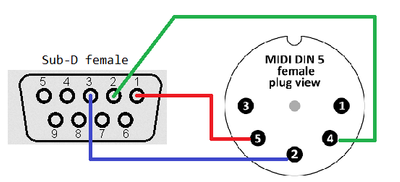

Sorry for digging up the old thread, but i recently got a "CMS-401 II" card and i'm trying to make a breakout calbe for it.
First of all - thanks for the great collection of data (pictures, manual, etc.) of the card! 😀
I'm struggling a little bit with the pinout for the cable...
@Cuttoon: Could you maybe confirm if this pinout is correct?
26.64 KiB
689 views
Reply 16 of 20, by Rolling
Meanwhile i built the cable with pin layout mentioned above and borrowed an MT-32 to test the card, but sadly without success... No audio output and no sign on MT-32 display that it gets a signal... 🙁
Does anyone maybe have this card and confirm the pin layout for the cable?
Maybe i'm missing something else...?
Reply 17 of 20, by Rolling
Small update: I tried changing some chips to no avail...
I guess without Cuttoon's help i'm not going to solve this mystery. Sadly i can't write him a PM to ask him kindly for help, because i'm quite new to Vogons...
Could maybe someone give him a hint, to look at this thread? I know it's an odd request, but i really don't want to spam multiple posts in this awesome forum, just to reach an random post count to send a PM... 🙁

Hi there, thanks @ vetz for the message and sorry to you - the vintage bug keeps hitting me in strange intervals, between which the activity withers away again...
So, right now, I don't even have my equipment right at hand, but AFAIR, what I did for my 2020 pinout:
I merely looked up the conventional pin count of a db9 and a DIN and tried to detect the connections of the OEM cable.
Pin counts are a bloody headache, though and I utterly lack theoretical skills. (i.e., I'm simply not an engineer.)
First thing that comes to mind:
Your schematic makes sense to me if applied to the db9 on the card, but...
There might actually be a fixed global convention for plug schematics. (There isn't for numeric keypads, building floor count, etc., etc....)
Alas, I don't know it.
My inutitive hands-on personal-on-the-fly count meant to be "from left to right" looking at the plug on the cable, not the card from the "outside", so, against the cable, not with the cable, just as I applied the continuity tester.
Same for the DIN - my count was looking at the openings of the connector.
Most likely: You have to mirror the approach in your schematic, as my db9-1 was actually your 5. Sorry.
Please check if that solves it and feel free to ask further, but it may take a while until I get back to that stuff to check again.
