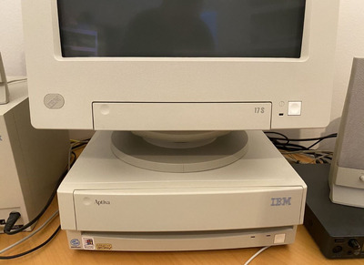

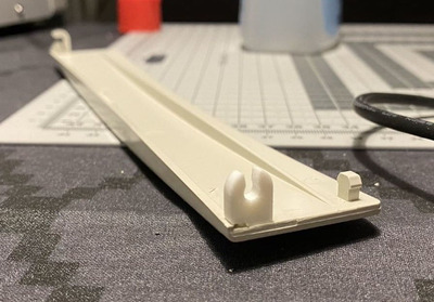

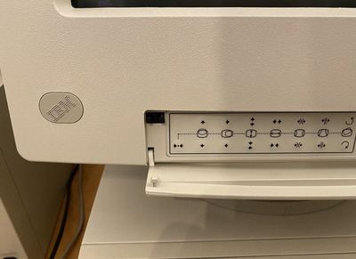

CrFr wrote on 2022-02-14, 08:57:First 3D-printed spare part I've ever made 😀 Repair part for my IBM monitor control door hinge. I only replaced left side, but right side might need some attention too. It is cracked, but still hanging in there, so I left it alone this time.
looks good, this is a great way of replacing small parts like this, 3d printing forms part of the future of vintage
Great job, dude! 😃👍
3D printing is just so neat!

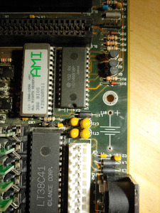

A succesful evening. Removed the leaking battery from a 386-board I unexpectedly got last week. Fortunately there were no signs of critical damage on the board and indeed it's still working 😀
My second PC was a 386/40 so I can rebuild my system from back then (or at least a similar one)
Ah good, you did actually get it, and it's not badly affected by it's battery vomiting. I want all the 386-40 mini boards.... All. Of. Them. 🤣
Good save, my friend. Got lucky on a couple of boards and the rest, not so much.

HanSolo wrote on 2022-02-17, 00:13:A succesful evening. Removed the leaking battery from a 386-board I unexpectedly got last week. Fortunately there were no signs of critical damage on the board and indeed it's still working 😀
Nice. Maybe the board was stored upside down and none of the acid made it onto the board. Who knows? Thank you gravity. 😀
