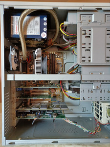

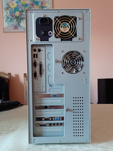

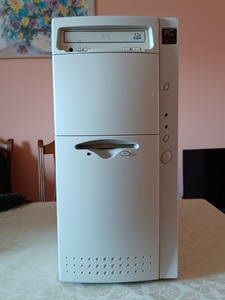

I really appreciate the designs of these early ATX cases. Maybe moreso then AT cases.
Sleeper build, anyone?
Very heavy and structurally sound case.
Main problem with sleeper builds is ventilation. Basically, you have to "destroy" the case to achieve that. Not a fan of that.
Neither a fan of that and there is the possibility of losing functionality especially with non-ATX cases.

FioGermi wrote on 2022-04-18, 17:08:I really appreciate the designs of these early ATX cases. Maybe moreso then AT cases.
Same thing 🙂
I actually used to not be a fan of the cases that had to make use of floppy drives with removed faceplates, because it would usually mean that any floppy drive in there would not have its faceplate and be kinda useless for to put into a different PC case.
But now I appreciate these cases more.
stef80 wrote on 2022-04-18, 17:18:Very heavy and structurally sound case.
🤣, nice pun 😜
And I agree fully. I have in some cases ended up making a new hole or improving an existing one using a hacksaw + filing the edges to not be sharp anymore + adding a fanguard (which I sometimes would have scavenged off of a dead or crummy PSU). What I do like is that they are solid and sturdy steel cases and I also like their aesthetics. The modern cases seem to be made of material thinner than canned foods cans with the pressed in motives in the sides and such being mostly there to improve sturdyness. The old cases didn't have that, these were sturdy because they were sturdy 😁
I often ended up using period correct cases for my builds mostly because of the limitation of its ventilation, but to me this is a part that I actually like.
Also the early ATX cases were the starting point of cases that didn't have a plethora of sharp edges inside the case anymore 😜

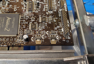

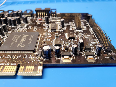

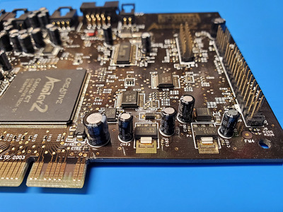

Repaired a crackling issue on my Audigy 2 ZS today.
During initial startup in Windows, it was putting out distorted sound with random crackles. These would subside after a minute or so, but still annoying. After reading on the forum about replacing the caps near the power, I opted to replace those four caps.
Unfortunately during the initial replacement, I failed to notice I'd created a short on cap C195. Whoops! This resulted in the Audigy 2 ZS not even being detected by Windows.
After diagnosing the short and replacing that cap (again), it works. No more crackling noises during Windows startup. 😀
Sweet. I should recap my sound cards someday.
Helpful info, mid-year sound cards are on the capacitor plague spectrum. I should probably replace a *lot* of caps.

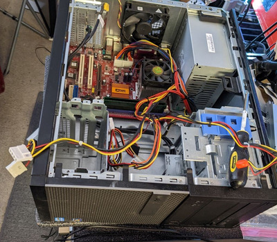

I mentioned older mobos in newer systems, I put a PCChips Athlon 1400 into a Dell Optiplex 3010 - I finally got the pinouts for the front panel connectors, though all the documentation is for re-using the mobo and not the case, you could puzzle it out. Unfortunately now I need to try to find a PCI USB card with standard Intel front USB ports for when I rewire the connector in the case. I like the early 201x Dell cases, should respond well to a little paint, new logos and stickers, and maybe color-coded LED fans behind the front grill. I was thinking white and grey fronts instead of black and grey stock, though we'll see if the first one I paint is a disaster. 😀 Only good for baby AT/microATX, of course, being "mini towers".
I worked on a design for a modular 5.25 drive bay adapter for floppies or card readers or whatever (though if I can find one cheap enough I'd go with that rather than spend a day printing something), and I already have an idea to convert the CPU fan to an 80-120mm fan (120 would have a large offset because of the PSU). The cables on this PSU were assembled by a blind man, though, lots of places where things going one place go around other things going other places, makes it tighter than it needs to be around the CPU.

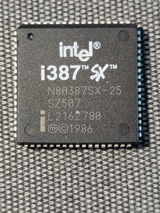

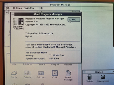

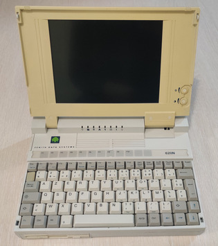

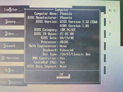

Bought an Intel 387 SX Math Copro for my Zenith Data Systems 620N ( it's a 386 XS )
387SX :
ZDS 620N :

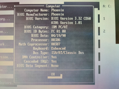

Before :
After, the Match Processor is detected
Started Windows in Extended mode and Virtual Memory ( hence the 7MB Ram displayed here )

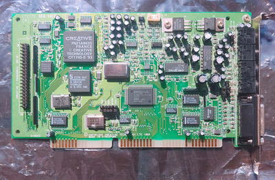

Cleanend the SB16 CT2770 that I bought some days ago. It was in pretty bad condition and cleaning with IPA didn't help. As some users here suggested I let it sit in warm water with dishwasher powder for some time and brushed it carefully with a toothbrush. Now it's all shiny again 😀
Strangely the stickers on the backside are still there but the text on the 46.6Mhz oscillator was washed away.
Some of the traces look concerning but I didn't test it, yet.
After
Wow that card looks like new again. Great job cleaning it up. Hopefully it'll work as good as it looks.
Did same with motherboard thas was probably used in a garage computer (very oily). I used liquid detergent. Dried it, and after that washed again with IPA, to get rid of any water/detergent under the chips. And sprayed liberally with contact cleaner 😀.

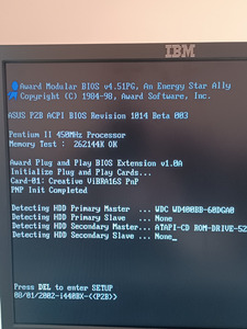

I must say, I'm very satisfied with Vibra16s/OPL3 [CT2890] in a config few posts back 😀. Ordered another one, they are cheap as chips.
