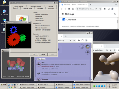

That's impressive when run natively. Keep in mind that any modern web browser can run on Unix, Windows 9x, and NT, if you cheat by forwarding a remote client with an X Windows Server. Something to look into, especially if you're running a Unix system.
It also makes downloading files MUCH easier, as you can access all of the modern SSL secured HTTPS websites that will not connect with older browsers. Use an rsync script to synchronize the download directory between the two systems, and it's almost as good as downloading the file locally, but with one extra step.
This is something that I've done for years. I haven't seen anyone else really do it though. It is somewhat difficult to setup, since it requires a significant amount of knowledge of both Unix systems and X Windows.
Modern Chromium browser running on Windows XP using X11 forwarding

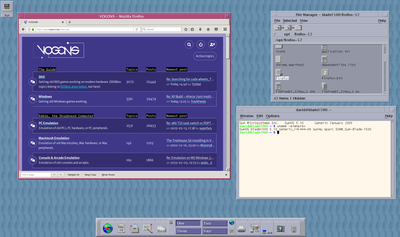

Firefox 52 ESR is apparently the last release for Solaris 10 - according to the readme Oracle laid off the team as soon it was done. Its from 2017 so for now at least its still new enough to load and render all websites I've tested so far.
The machine is a Sun Blade 1500 with a 1GHz UltraSPARC IIIi processor and 2GB RAM. Single core integer performance is similar to the Raspberry Pi 3 according to the p7zip benchmark so a bit on the slow side but not so much that the browser is unusable.

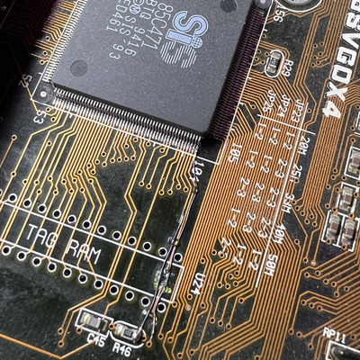

Still going through my pile of 5x dead 486 motherboards that I got in 2021 - it's the lot that essentially stopped me from buying up lots of vintage mainboards since I couldn't figure them out at the time.
Today I took on the Asus VL/I-486SVGOX4 which was the real reason I bought the lot. A VLB 486 Socket 3 with voltage regulator, coin cell powered CMOS and PS/2 mouse support.
I spent ages on this board the last time I took a look at it, it came to me with no BIOS ROM and the jumpers needed changing. The documentation for the board is fairly good though so I got those all right at the time, like a year ago when I packed this lot away last time.
I just could not get it to do anything and couldn't figure out why, I could see that there were some signals going on the ROM but didn't get anywhere.
Just randomly taking a look at it with a head torch on before installing components, I spotted some weird colour inside the TAG CACHE slot, some kind of bright yellow inside which didn't clean up with IPA.
Desoldered the TAG cache slot and...
1.42 MiB
1506 views
That's pins 104 and 103 on the chipset just randomly smashed and somewhat connected together now, which I'm pretty sure is not how it was from the factory. The "Address Status" and "Read/Write" pins which seem to run to the CPU. Can you guess what must've caused this? 😀

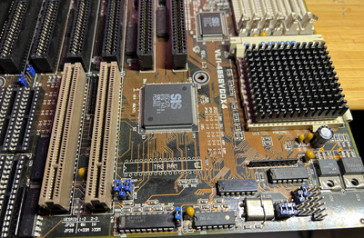

Wires put back in place with my trace pen and some superglue to hold them out of the way of the TAG cache socket legs:

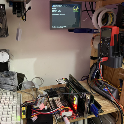

The board's just gone from "--" on the POST card to getting stuck on the memory check. Gave it some RAM and it beeped to request a video card. Now it boots:
745.58 KiB
1506 views
Quite glad I didn't give up on this board now, it's amazing how things can change just leaving stuff for a while to get a different perspective. I do wonder as well if I installed Cache on it without inspecting it completely and that lead to this situation. Which is great, otherwise I wouldn't have been able to get this board.
