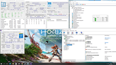

Took my Diamond Monster 3D II out of storage and put in in my old Win10 PC (i7 4770k on a Gigabyte Z87-D3HP with 16GB DDR3 RAM), installed the Windows 10 drivers for it and ran the Donut tech demo as well as Quake 2 with the 3dfx MiniGL driver. Still amazed that it worked so well.

Here's everything you need:
https://youtu.be/0s6IoQXBJNo

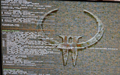

Only downside - it's not a signed driver, so you have to disable driver signature enforcement every time you want to use it (it resets after each restart).
The attachment Voodoo2.PNG is no longer available
54 fps in 800x600 with demo1.dm2 and the 3dfx MiniGL driver. With the in Quake 2 included 3dfx OpenGL it only had 45 fps

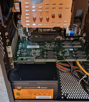

The attachment 20230530_132339.jpg is no longer available
The attachment 20230530_133901.jpg is no longer available
Good thing my board has two PCI Slots left otherwise I'd have had to use an adapter. Second one houses an Adaptec 2940AU that also has drivers for Win10 (that only required disabling driver signature enforcement once)

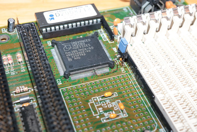

Finally got around to upgrading my Abit AK3 / Auva TAM/40-U2 motherboard so it can turn off the built-in CPU, with the intention to add a socket and install a TX486DLC in there.
I used this very fine leg puller to get FLT# (pin 54) out while heating with my finest soldering tip, it was originally connected to VCC:
The attachment Abit-AK3-Adding-Socket (1).JPG is no longer available

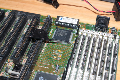

Then soldered a 3 pin jumper over a bypass capacitor since that connects to both VCC and GND in one spot. The middle pin connects with magnet wire onto the FLT# pin:
The attachment Abit-AK3-Adding-Socket (2).JPG is no longer available
Stopped here to test with the post code reader card to see if the board would be dead when I connected FLT# to Ground. It was 😀 Then that it would work again when switched back.

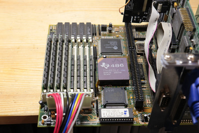

So I installed the CPU socket and fitted the new CPU. It gave post code C1 so that's a memory error, then there was a bit of weirdness with it not wanting to start with some sticks of RAM. Rearranging the RAM the CPU is now working? It boots up and the Award 4.50 BIOS supports the Internal cache so it's definitely using the 486DLC.
The attachment Abit-AK3-Adding-Socket (3).JPG is no longer available

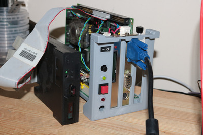

Now I'm gonna upgrade some more 256kb 30-pin SIMMs and test those out - earlier I was testing out a load of 72-pin SIMMs on my 486 SBC
The attachment IMG_1387 (Custom).JPG is no longer available
It doesn't even have a hard drive / CF card right now, just boots up with whatever RAM that's fitted and boots off the floppy into MEMTEST.
