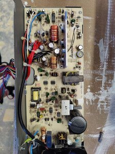

Reply 24441 of 29860, by OSkar000

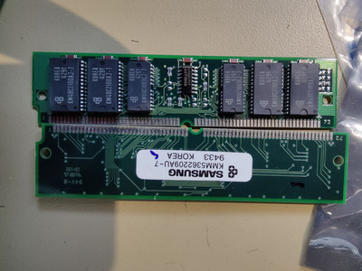

I went thru a bag of random 72pin memory modules to find something for one of my next projects.
The attachment 2023-06-05 20.58.49.jpg is no longer available
And found 2x8mb FPM... not much but enough to boot a system that doesn't run with EDO.
The attachment 2023-06-05 21.05.14.jpg is no longer available

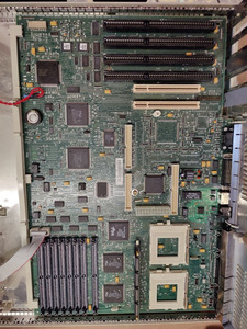

Last week I took a peek inside the PSU and it looks ok from what I could see.
The attachment 2023-06-05 21.05.06.jpg is no longer available
And to make everything as eay as possible... a huge motherboard with lots of fun stuff on it 😀

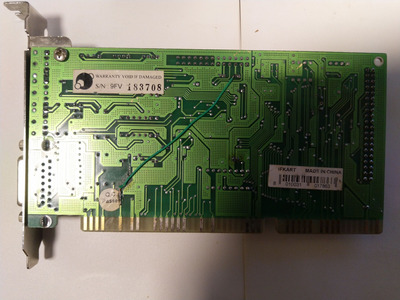

I somehow created a card that blew out the AGP port on my test rig by attempting to reflow the VGA port on a GF2Mx that had a dead blue channel.
There are no solder bridges I can find... I'm honestly more dumbfounded than angry. Like how does reflowing the VGA port cause the card to blow up the AGP port? As soon as I turned the PC on I got the magic smoke from near the front of the AGP port. Now it doesn't even recognize when a AGP card is installed, still boots off the integrated graphics.
Kind of sucks, the nForce2 with Integrated GF440Mx graphics motherboard in that thing is kind of rare, but I have another one held as spare so no big loss to me personally and that IS sort of the job of the test rig, to fall upon its sword in place of a more unique machine if something goes horribly wrong.

Bummer.... any of those small SMD electrolytics near it that could have cooked to a short?
I had a try at burning something on the graphics side myself today. Acer SFF box, again forgot the rule of "If you didn't build it yourself go through it with a fine tooth comb before you power it up." ... because it had no video .. well not out of either onboard nor Gt710 15pin VGA, after turning it on and off enough times to mangle the windows install (maybe... it might have been improperly set up or halfassed) I realised the GT710 didn't have it's VGA header plugged properly, it was on a single row of pins, gah... so risked blowing something there maybe with less forgiving monitor.... anyhoo, sorted that, booted... munched windoze.

Not that I could see with the motherboard in the case.
Going to pull the board at some point. I think it actually burnt out the traces for the +12v on the AGP port though, so likely not fixable.

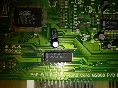

So far I patched the burnt trace,replaced a funny looking cap, with a needle went through between the legs of the ES1868F chip and checked if there is any shorts between them, then made some turn-on tests with an expendable PC, but without monitor. Based on the boot sounds and beeps the card doesn't make a difference in an obviously bad way, nothing blew up.
The attachment IMG_20230606_085123.jpg is no longer available
The attachment IMG_20230606_085026.jpg is no longer available
The attachment IMG_20230606_083615.jpg is no longer available
Not my best soldering job, but seems to be alright for now.

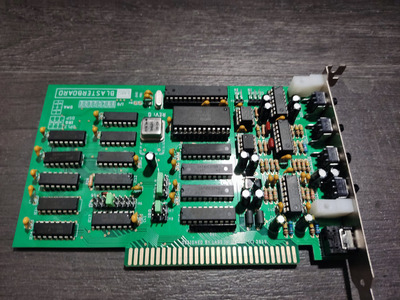

Reply 24455 of 29860, by rkurbatov
Finished soldering of this beauty from Labs. If somebody is interested - more details in his topic (BlasterBoard 2.0). Very nice card, perfect match for 80386.

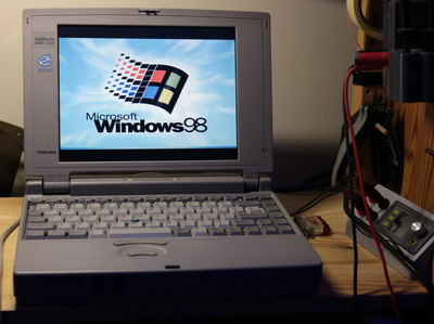

I have had such an ordeal! I've been trying to get a working screen for my Toshiba Satellite 400CDT since the lower 1/4 row of pixels didn't work - I bought a 'new' replacement LCD from focus_memory on thebay and that replacement LCD had the same fault and had some really weird flickering problem. They sent me a new one which worked for almost a whole game of solitaire then it blanked out never to work again.
I just can't deal with getting either of these sent back or replaced again and I bet the seller would hate me for it too. The return was about to close anyway so I dove into both displays.
Display 1: Taking the metal front off, there was some weird black tape over one of the row-segment drivers - this LCD isn't new or old-stock at all and has been repaired! unlike my first display where the row-segment was corroded off from a drink spill, this one's row segment driver was a clean break on the actual pins that are soldered to the controller rather than the part that's glued onto the LCD panel. So I put the fine tip on my iron and used a PCB scrap to push down the flex PCB of the row-segment driver onto the control PCB and soldered it down. Now LCD #1 is working! if I'd opened it up before I could've saved weeks and the LCD is really nice now that it works.
The flickering problem? This LCD panel has 3x control boards, one with the main processory chip and the row-segment drivers, one with the column-segment drivers and a PCB that looks like it generates some voltages and other signals. The broken LCD panel that was in this laptop to start with I kept the parts of it for future use, good thing I did because they fixed two LCD panels... The voltages board has 6x small variable resistor trim-pots and adjusting them while the laptop is on can do some odd things, reduce/increase flickering, brighten/darken the panel, introduce ghosting. The parts-panel I had, I swapped the voltages-board from that and the display looked great.
But I don't want to waste this part on this LCD, so I initially measured the trimpot values and tried to match on this LCD's original voltages-board. That worked, but what worked better was just visually matching the positions. I guess there are enough capacitors and other things in the circuits that measuring values in circuit won't work. But these are 1x turn tiny trimpots so just matching them up visually meant the original voltages-board from this LCD can be used.
At least with the refurbishing they fit a new front polariser so polariser-breakdown is a long way away for this panel and it looks fantastic.
Display 2: Looking at the back of this LCD that turned white mid-use, it appears to have been in the ocean for a while. All of the chips on the 3x control boards and their board-to-board connectors have corrosion. And the plastic part of the LCD was all smashed up. Really glad I kept panel 0 for parts.
At this point I'm very familiar with the LTM10C021 panel from Toshiba. It's way less integrated than later panels and uses 2x board-to-board connectors, lots of failure points where corrosion gets. So again I used the parts from the broken display panel to make this one work, taking the voltages-board and replacing a board-to-board connector which ugh, actually required using the microscope. It worked after I cleared all the shorts.
Of course my work on it was a bit heavy-handed and the chip-on-film connector for one of the column-segment drivers got separated from the glass a little, so there's a bunch of funny coloured strips on the right-most columns of the panel, but it works again!!
So to fix that, I used some of the rubber strip that from the parts-panel that's used to stop dust-ingress. Cut that up to fit the last column-segment driver and layered a few of these little rubber strips, now with the metal front in place, that presses down the mylar flex-pcb onto the LCD glass's contacts and the rightmost part of the display looks good again.
An ordeal, but at the end of the day I bought one panel and now I have 2x working panels, so okay. Focus_memory handled my complaint pretty well but the selection of available parts for old computers is getting rather limited.
