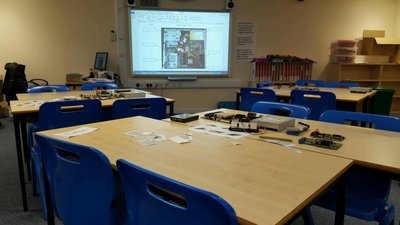

I taught kids basic computer architecture using some oldskool systems like slot A, socket A, slot 1, socket 939 and an AGP 775 board. They loved it!

Good, good.... Turning youngster's to the dark side. (Of retro computing) 🤣

Nice! 😁
Lol!

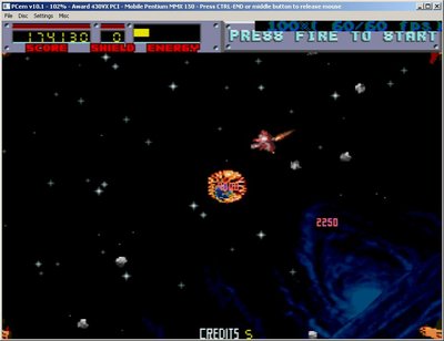

When Fraps fails I just try to get Virtualdub to record the window of whatever i'm playing. Requires preparation though 🙁 still better than Unregistered Hypercam 2
and random emulation-in-emulation screenshot to the thread because why not? At least both show 100% execution 😀
long live PCem
