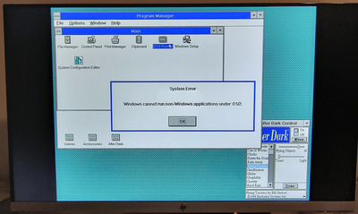

A couple of months ago, I got the idea to try to install Windows 3.0 within the OS/2 1.3 DOS environment on my Pentium 4 Retro Rocket from watching a NCommander video on Youtube. Unfortunately, Windows 3.0's setup program gave me out of memory error messages. In fact, every DOS program I tried within OS/2 gave me low memory errors even though they all worked before. I spent several days troubleshooting to try to figure out what I might have done to change OS/2 to make it behave this way. TCP/IP stopped working as well, but I thought that was an unrelated issue. I ultimately gave up to focus on other projects.
Yesterday, I decided to perform a clean install of OS/2 1.3 on the Pentium 4 and try to install Windows 3.0 again. I installed OS/2 1.3 in VirtualBox first to make sure it would work with Windows 3.0 in the DOS session, which did install properly. The DOS session after the fresh OS installation on real hardware still gave me the same memory errors, though. I was stumped again.
I figured the issue must be in the hardware. After checking to make sure I had all of the expansion cards seated on the motherboard properly, I started going through the BIOS settings. That's when it hit me. I had the system memory configured for "Non-OS2" instead of "OS2" in the "OS Select for DRAM > 64MB" setting. I know that OS/2 uses a different method to address memory above 16MB and again above 64MB, but I never thought this BIOS setting would affect OS/2 1.x given its 16MB limit for memory access. But, sure enough, the OS/2 DOS session started working properly as soon as I changed that BIOS setting back to "OS2". It also looks like this issue affected my TCP/IP sessions as well.
On a positive note, Windows 3.0 in the DOS session can use the built-in 8514/A driver compatible with my Retro Rocket's Mach32 video card (an ATI Graphics Ultra Pro PCI). 1024x768, 256 color mode makes this effort a little more interesting. I just wish Windows 3.0 didn't have to operate in "Real Mode" within OS/2 1.3's DOS session. There's not a lot of Windows 3.0 software that works in "Real Mode". Here are a couple of screen pictures.

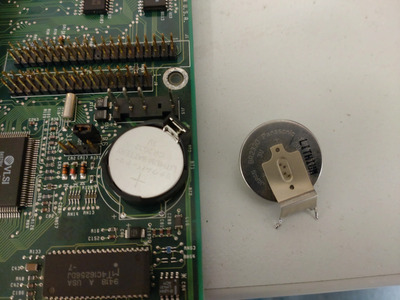

Also replaced the Lithium coin cell battery with a CR2032 holder.

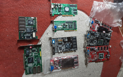

I did a scavanger hunt of a few sueboxes I had on my shelf and looky what turned up (I totally forgot I had) all this , some ram and 2x Ti4600's also...(my mind is blown I totaly forgot I got those in my vintage GPU broken collection).

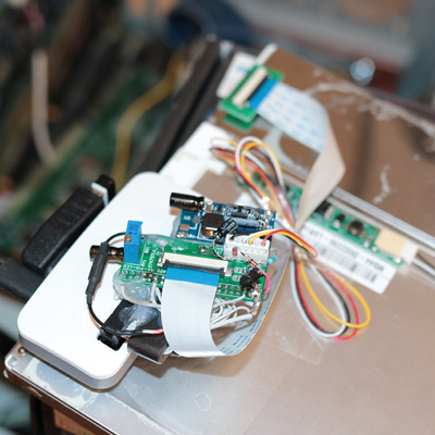

Lately I've been doing not-retro things with retro things. For instance all that playing about with parallel LCDs that I've been doing lately, on Advantech industrial boards. I've now discovered that those same LCDs can be run very easily with a Raspberry Pi from its GPIO pins, even a Pi Zero. This thing looks like a hacky mess, but it works properly and I didn't have to wait to get a replacement PCB 😀
1008.73 KiB
1348 views
This should be nice to have for testing out LCDs in future. It's much easier to change settings for it than the VGA BIOS editing required for CHIPS LCD controllers.

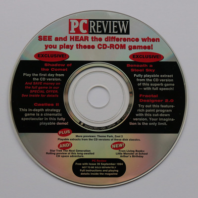

I also found that an old PC Review CD-ROM coverdisc I kept which doesn't appear to be uploaded anywhere so I thought I'd archive it. There was a huge scratch on the bottom and even after polishing it's impossible to get a complete image, so I ripped the files I could and patched together the full image again. Learnt a fair bit about how to use PowerShell to set all the file created/modified times to match the original CD's times, since copying them across set the created times to current day instead of 1994. Now I can upload this and it's safe from further disc-rot 😀

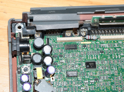

Taking it apart, my first task was to rebuild a load of broken plastic that held the left hinge in place. Initially I tried gluing the bits plastic from that screwhole back together but then they broke in a new way. So I used a steel washer to make the screwhole's 'base' and crafted some black mouldable plastic that melts in hot water to rebuild it:

It's stronger now at least, the hinges feel a little less floppy.

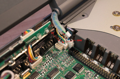

Going deeper in, this connector with 6 pins runs the keyboard and mouse PS/2 ports - why is the black wire 5v and the red wire Ground?? Lots of bodge wires too

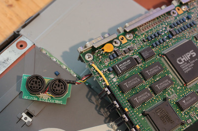

Took the motherboard out and followed the circuit around - the 5v trace goes into L37 which goes to 5v. Which no longer has any connectivity, it was that little blue block down by the PS/2 ports.
704.1 KiB
1287 views
That's an inductor which is apparently rated for like 250ma so I can see why it broke running an external mouse / keyboard. I have some 500ma polyfuses left over from my HardMPU builds so the 5v can run across that instead - maybe that inductor was the fuse? Don't think polyfuses existed back in 1993, but it has a fuse now.
Put it all back together and now it detects my optical mouse, much nicer to use.
Cover discs were amazing. I think a lot of people were excited about collecting anything and everything on CD-ROM to build out their collection. CDs were a very exciting time in the 90s. It really was a multimedia revolution.
Reply 24519 of 27687, by Joseph_Joestar
Kahenraz wrote on 2023-06-18, 14:58:
Even today cover discs are an extremely useful resource for retro PC gamers.
You can find all sorts of drivers on those, some of which are no longer available anywhere else. Browsing the archives of shareware programs and game demos can be very interesting too. It's pretty much a direct window to the past.
