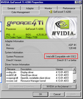

In my testing, I found that the optimal driver version also depends on what instruction sets your CPU supports.
For example, it's generally recommended to use the 30.82 driver for an AGP4x GeForce4 Ti4200. However, I found that the 40.72 driver provides a non-trivial performance boost on my Athlon64 system because it can utilize SSE2, while 30.82 can not.

That's true! I also had a significant performance boost on my Athlon 64 machine with one of the newer drivers. I couldn't remember the version number though, that's good to know.
I've also read that some of the later drivers (20.x and upwards) made use of MMX instructions to improve performance. I would have loved to try that on my K6-2 machine, but alas, none of the newer versions worked for me. Does anyone know which exact version added MMX support? Maybe it's in the release notes somewhere?

I'm not sure, Nvidia's readme files seem to be a bit sparse on what was changed in which driver version. However, the driver control panel does sometimes show which instruction sets are being used. Here's a screenshot from the 40.72 driver on my Athlon64 system:
The attachment Nvidia_SSE2.jpg is no longer available

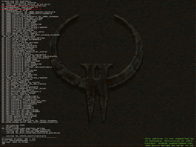

Additionally, I noticed that Quake 2 shows which CPU instruction sets it uses when you open the console after changing the resolution:
The attachment Quake2_SSE2.jpg is no longer available
Note that I'm using the 3DNow! optimized version here, so that may have something to do with it as well.
