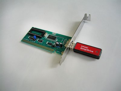

Has anyone here used an isa usb controller card before?
How do to perform? Do they work well? Can they be booted from? I'm guessing a pci usb card would be better in every way possible.
I attached an image of one for those who never seen one.

My thought is that this would be a simple way to get data on or off an older 486/386/286 system. And maybe mouse/keyboard.

I don't think I've ever seen that one, looks like a modern card? Can you tell me more about it?
I did a lot of research into ISA USB cards back around 2003-2005, I may still have my notes somewhere.

Drivers would be the problem, this is why I can't see them being that useful.
But the page I found the image on says the card came with a flash card driver.
Here is the page I found it on.

Form the page I found it on, it's a USB ISA CH375 card and can be bought from china for around 20$. I found one site selling it for about 24 USD.
I think a dual port 16bit card would be far more usable for a use mouse/keyboard, but drivers might be a problem.

The most interesting thing is it has a Boot ROM. Could be very handy, depending on some technical questions.

Wow a real working ISA USB card (8 bit too)
I am sure it is slow with 8 bit ISA though
